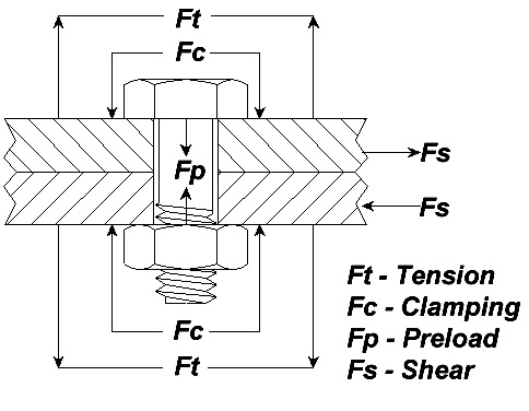

msiminoff wrote:
7ofus wrote:
I would love to see the force diagram of how the clamping force on the studs translates to the radial force on the hub centered wheel.
Okay, since you asked...
Note that due to the clearance fit, there is no force transmitted by or as a result of the centering feature. Neither this force diagram nor my previous explanation have anything to do with wheel centering. Keep in mind that many vehicles use only the wheel studs for centering.
I believe that you are proving the need for friction on the hub face to wheel interface, and I do not disagree with you. I am suggesting the need for lube on the hub center to wheel interface - which is unaffected by the stud clamping forces. We are arguing different points. So how about we both win?

7ofus wrote:
msiminoff wrote:
Yep and that centering interface was all I was saying it is O.K. to lubricate, not the entire hub or wheel surfaces. The lube on the wheel pilot to hub interface will prevent the wheel sticking to the hub due to rust at that very close tolerance interface.
