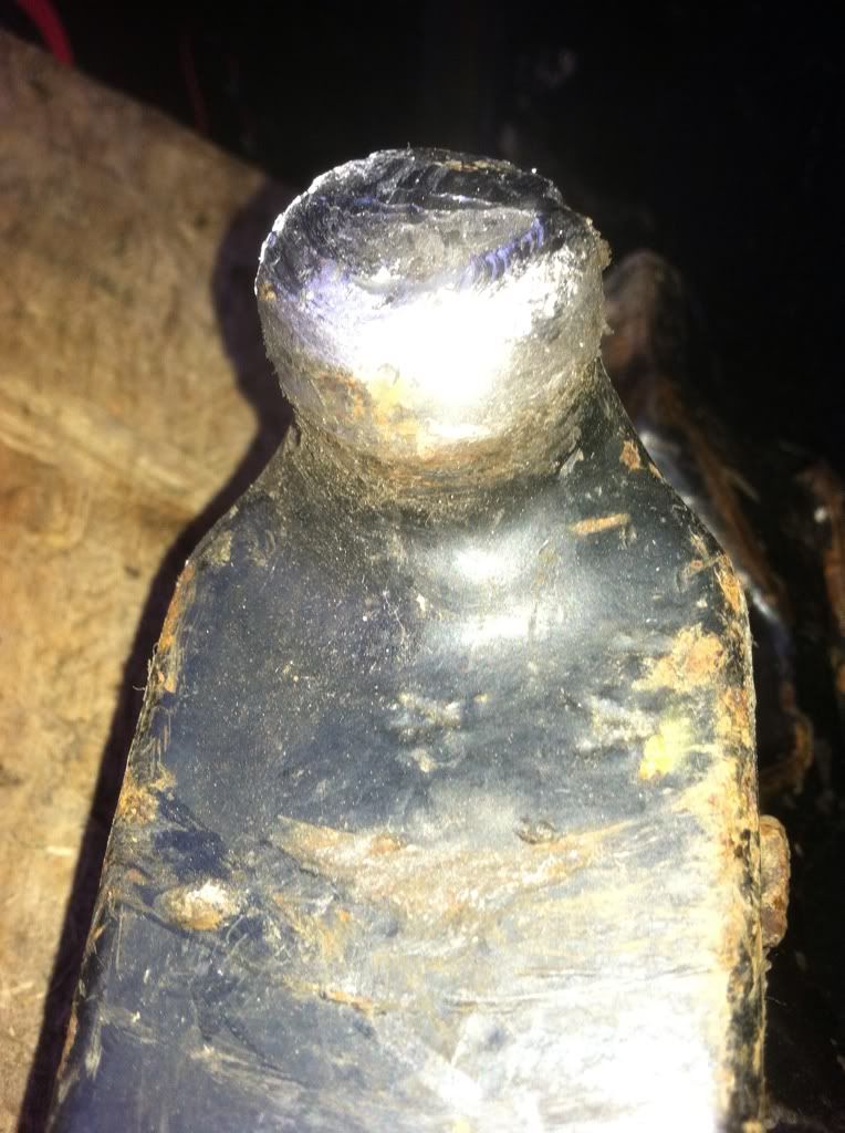

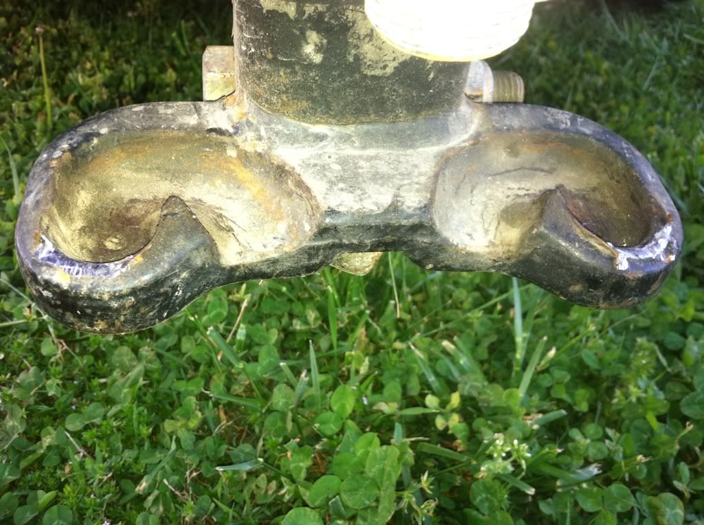

Here is another for you then.
What happens when you DON'T properly grease your hitch?
You will have metal on metal wear and eventually, you will experience hitch failure.
My the bottom pockets from this trunnion hitch were NEVER greased by the previous owner, Eventually the wear was so bad (and irreversible) that the WD bars literally pulled out of the hitch head.
Here is a picture of one of the trunnion bar ends.
All said and done.
Grease your hitch, It is WORTH it.
