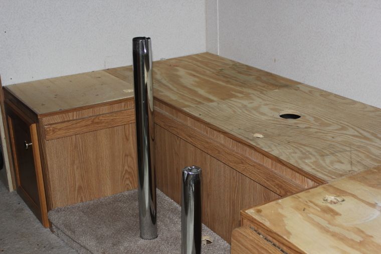

Just back from an 8 day boondocking trip around Mt Shasta. The seats worked great! I love to swivel mine and kick my legs up against the bathroom wall. I wish the seat back would recline, but I'll have to work that out. Here's the first photo, showing the dinette with table legs in stock location.
The one leg is cut off to fit in the large hole after the table is rotated 90*. You can also see the new hole for the long leg.

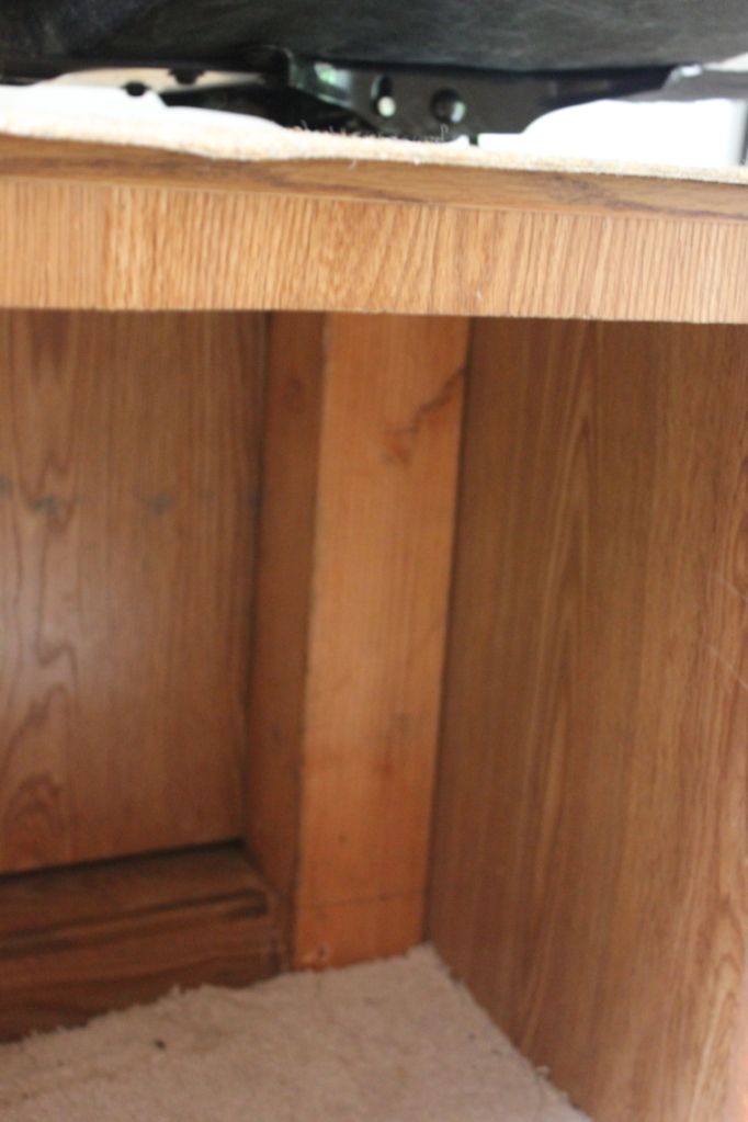

Left cabinet 4x4. You can see the bottom of the seat above. The right cabinet is similar. As Popeye noted these 4x4's will be custom to your particular TC. I had to rabbit the left bottom 4x4 to clear some floor channel. This system might not work on some shorter model TC's.
