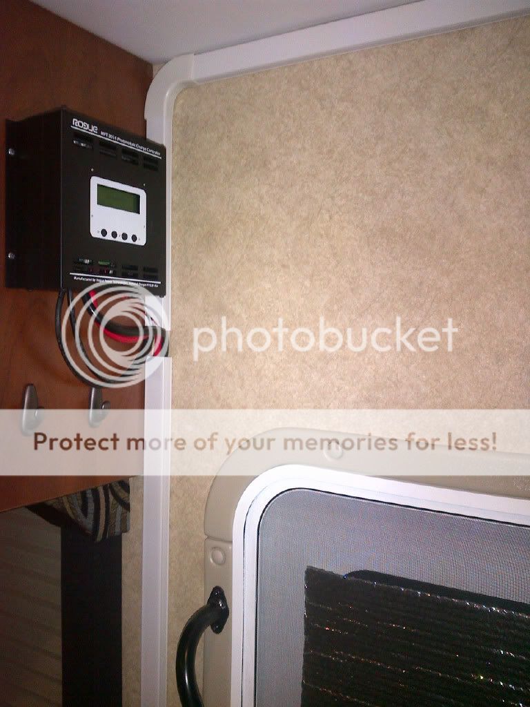

If if you don't think of anything better, you could put some of that plastic split loom wiring cover stuff over the wires.... white would kind of blend into the wall color. Amazon has some - for example THIS
In my rig, much of the factory wiring is pushed tight into the inside corner between ceiling and wall (or wall and wall for vertical runs) and then covered to hide it with a strip of paneling a few inches wide installed on a 45 degree angle between the wall and ceiling (or wall and wall for vertical runs). They used color-matched paneling, and just stapled it in along the edges - but you could use small screws so you could get at it easier. I've removed various pieces of it to modify wiring, and then stapled it back when done. They have plastic trim slipped over the edges of the paneling strips, but you could just cap the edges with white or colored electrical tape and it would look fine.

That's a nice solar setup you have. You might want to look for some plastic wire-way molding to cleanup and conceal the wiring. here is a link for a typical wire-way. http://www.cableorganizer.com/panduit/pan-way.htm
There are several manufactures you can get this from

Thanks for the cable organization links. Definitely will be covering them up -- just need to find time, etc. :-)

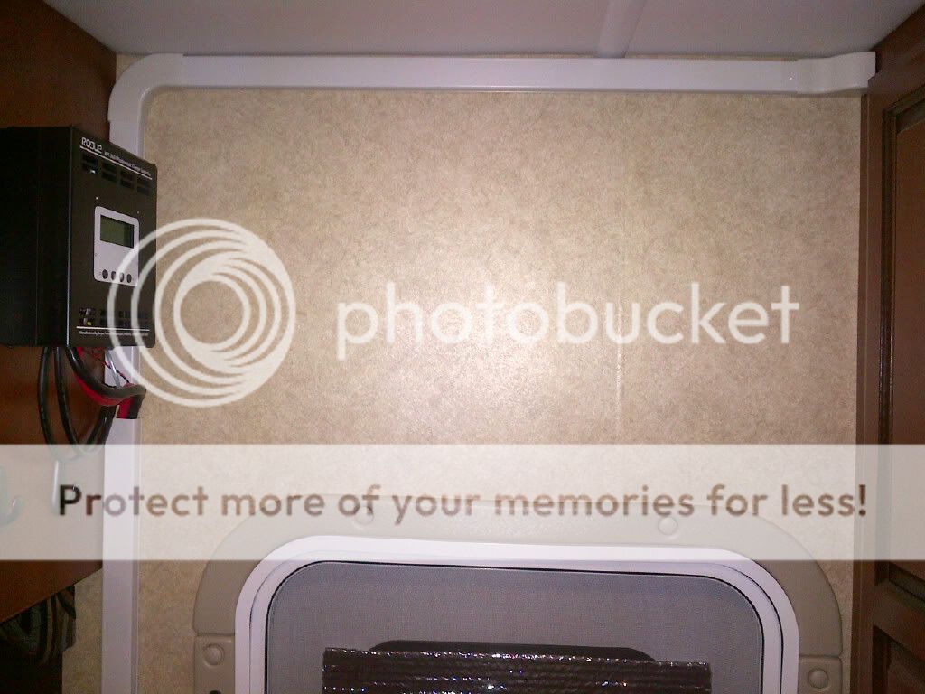

69gp,
Thanks for the link to the molding stuff. I had been looking, but nothing popped up until your link. I ordered some stuff from them and things ended up like this:
Thanks!
