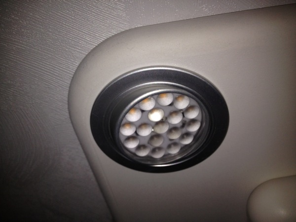

Well a few weeks ago I came across some "puck" style LED lights at IKEA and I realized that I can have my cake at eat it too... the extra-bright (but 2 Amp draw) fluorescent for use during meals and the LEDS for energy efficient lighting at other times. I soldered together a simple PWM dimmer circuit which allows me to control the brightness and current (from ~50mA to 450mA). The dimmer/off knob is located in easy reach of my son's bunk so he can use it as a night-light.

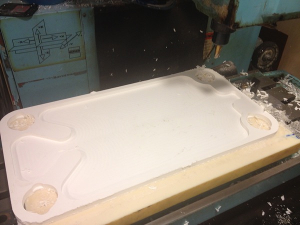

I didn't want to drill any more holes (for mounting or wiring) in my ceiling so I made a lightweight mounting panel from a piece of 13mm Sintra. This panel is sandwiched between the flouro' fixture and the ceiling.
The lamps look good, provide plenty of warm light and can be swiveled a few degrees in their mounts to put the light where you want it.
I can select fluorescent, the LED's, or both. In this photo you can see the dimmer/off knob mounted in the end panel of the fluorescent fixture.
