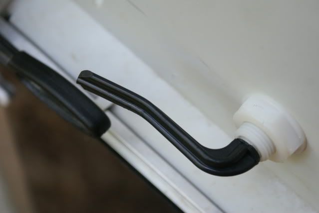

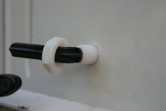

As requested by others, I’m attaching some more pictures to show how I added a toilet flush handle to the screen door. I used one made of plastic but I suggest using one that has a metal rod. That way you can bend the rod as needed in order to make contact with the screen door handle. I had to use a heat gun to slightly bend the plastic on mine.

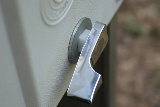

I also have a flat washer on the back side as you will see in one of the pictures. I intend to change it out with a smaller washer but the larger one is all I had at the time.
Its an optical illusion in this picture. The two handles do make contact when in use.
