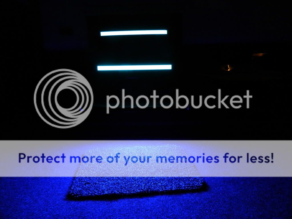

I installed a strip of LEDs above my steps... I used a strip of automobile accent LEDs. I mounted the LED strip underneath the camper above the steps near the camper's edge. The negative lead was grounded to the frame and the positive lead was ran in the door frame to a switch beside the door.
It works very well illuminating the steps without putting off a lot of light.

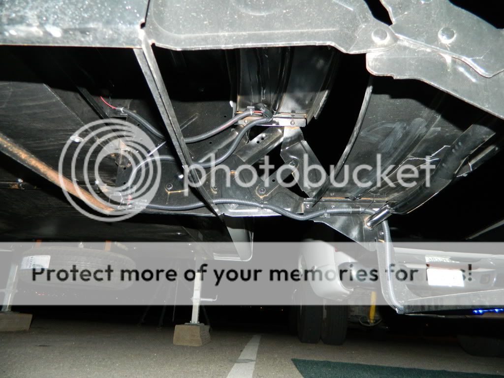

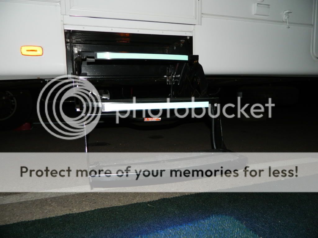

Downtheroad showed the RV step light. I have personally installed it and here is the results.
On the bottom step I mounted 2 12" led strips I picked up from PEP Boys.
Majority of wires are protected by plastic wire wrap. Everything operates smoothly and the wires are protected as the steps are pulled out or retracted.
The amber step light that was original and hidden in the back of the step well was worthless. I pulled the bulb assembly out and it acts as a junction box for the wires.

I purchased ours at WalMart for about $12 for two 6" strips. Mine are blue... I'd prefer clear, but they did not have them at the time. I did not trust the double sided tape and used a couple insulated hold down clamps I had laying around.
Initially, I mounted the LEDs a bit close to the frame, but did not get the illumination I expected. I later moved them closer to the edge of the camper and get much more light now.
