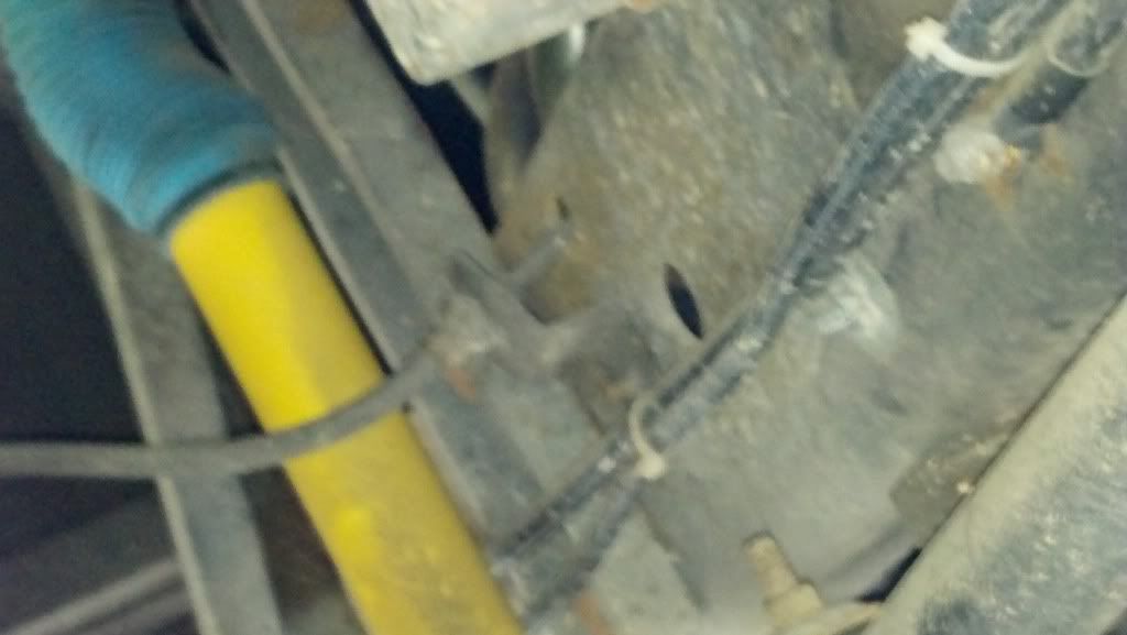

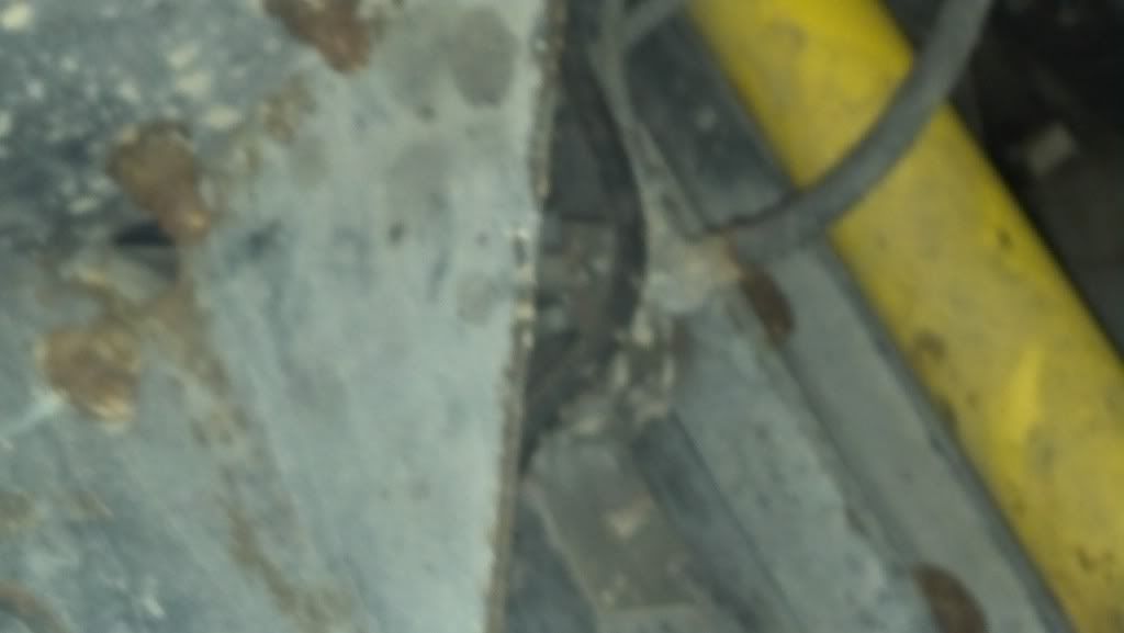

RLS7201
Some Where
Joined: 10/26/2002
Posted: 05/03/12 10:03am Link  |  Print  |  Notify Moderator
How about one of you 96 F53 owners (hint hint Eric. GRIN) go look at a front brake hose and tell us if it looks like picture 1 or 2............Inquiring minds want to know.

96Bounder30E
America is my home!
Joined: 11/21/2002
Posted: 05/03/12 04:38pm Link  |  Print  |  Notify Moderator
OK RLS7201........for the record........here is what the brakes fittings look like on a '96 F53 chassis.......
