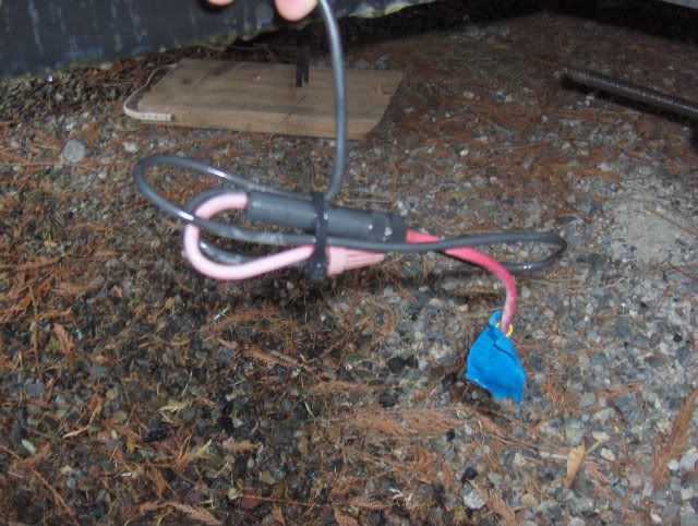

Here you go anaro if you still are needing a visual..
It was pouring rain when I got home last night and didn't let up, so I got these this morning.
Here is what the wiring part looks like. It's just as you surmised earlier and just how mine was when I got it setup.
I have the connector taped up, but it's just a crimp type of connector with a round 'eye' on it that I attach directly to the + battery post along with the one for the trailer itself.
Here is how it's attached to the trailer. When I said before that there was a ground wire attached to the bolts, I was wrong.. Notice the washers on top. They 'dig' into the metal enough to establish ground thru the jack itself.

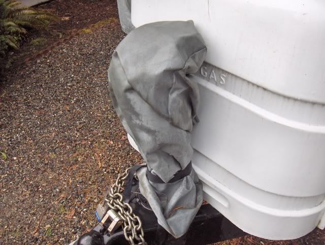

Here is the cover I use. It's the same breathable material that the RV cover is made of and keeps it pretty dry, yet does not hold any moisture. It came with my RV cover, but I don't remember what it was for??

It's to put the RV cover in when you take it, the rv cover, off the RV....lol.

Now that would be something! It did come with a bag for the entire cover too, but it's never been back in it! Figured I could use it if I needed any patch material for the cover.. So far it's been good!
