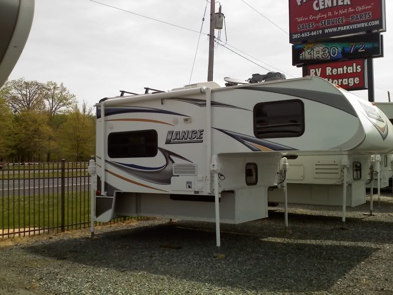

Hello All,
I am new to the TC Forum but have been along time class A owner. We just recently purchased a 2010 Lance 850. Nice change from a 33 ft Fleetwood. looking to upgrade my Chevy Truck. Its a mint condition 83 with the camper special package. Glove box sticker says its rated for 3231Lbs.
I have search and read may articles about shocks, still want to hear first hand stories of what you use and why. If you dislike a particular shock please let me know why. remember this will be one of many upgrades but I feel its critical being a single wheel truck.
thanks Michael
