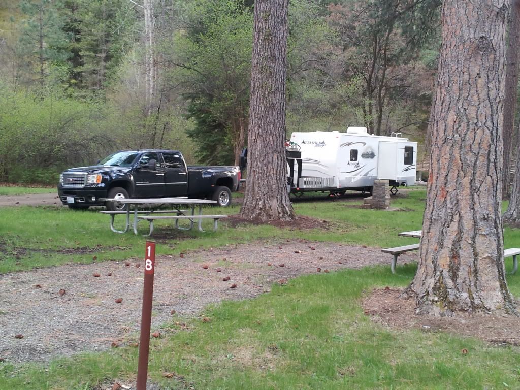

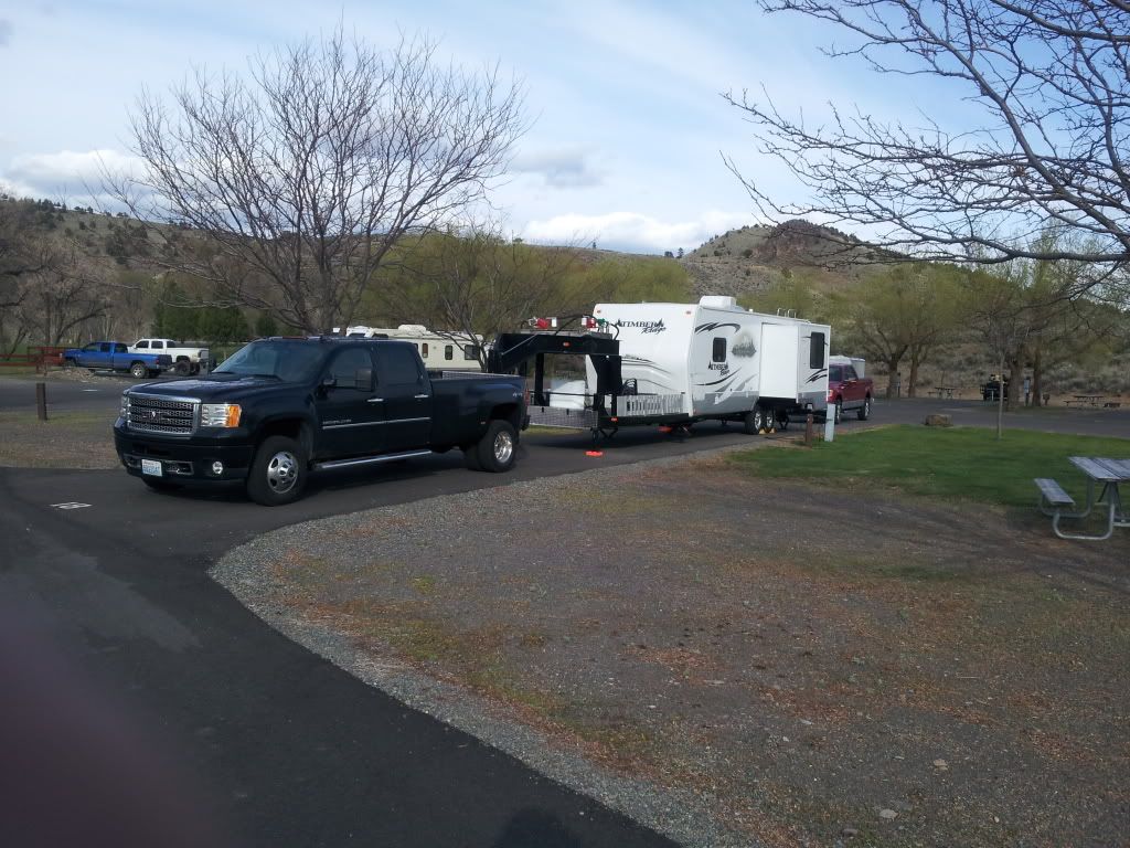

This is my gooseneck conversion trailer. We used it for the first time this past weekend and it tows great. There were no issues at all everything worked as expected. I was worried about the pin load on the truck but even with 56 gallons of diesel in the top tank I had no problems with it.
This combination is great for towing in wind too. We had about 30-40 MPH gusts when driving to the campsite on Friday but there was no movement that I could tell from the drivers seat.
Here we are all loaded up and ready to leave.
The first campsite at Unity Lake Recreation site in NE Oregon.
And here we are at Catherine Creek state park also in NE Oregon.

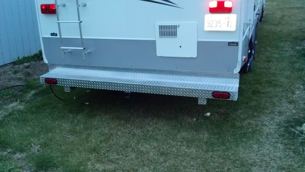

Here is a pic of the rear bumper cover I made for the trailer.

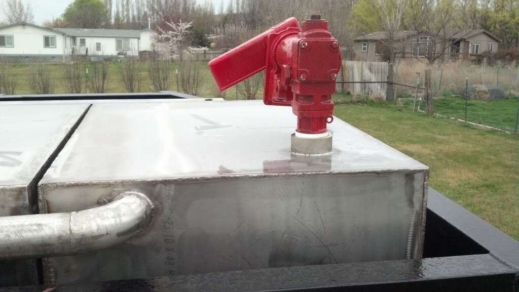

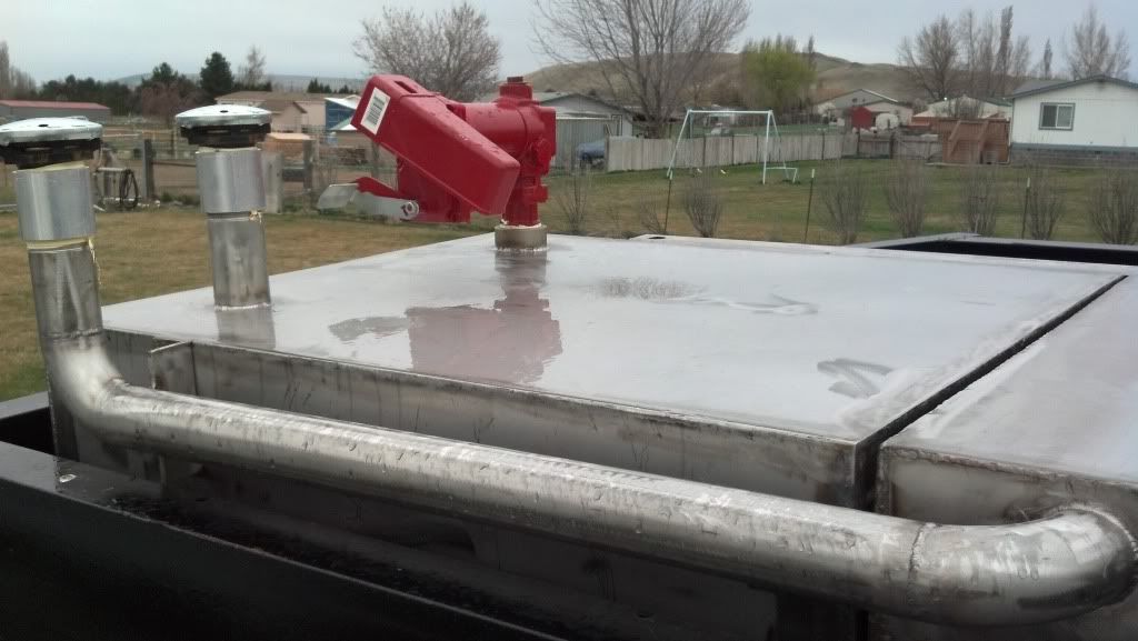

And here are the fuel tanks which are located on top of the gooseneck.
One tank is 75 gallon for diesel and the other is 40 gallon for gas.

Being that those tanks are transfer tanks or refueling rigs have you had them checked out for DOT certification? You may need to have HazMat placards and associated tags.

wondering that my self the diesel is fine allowed 110..the gasoline is another story..technically you are only allowed 5 gallons before needing placard...last I knew...

The fuel tanks shouldn't be an issue. Many toy haulers come with gas tanks in them, some with as much as 50 gallons too.

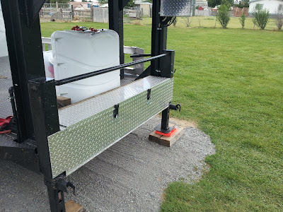

A while back I said I would post some pics of the different items I made for this trailer.
Here is the battery box.
Here is the trickle charger wired into the battery bank.
The control box for lights and the keyed switch for the fuel pumps.

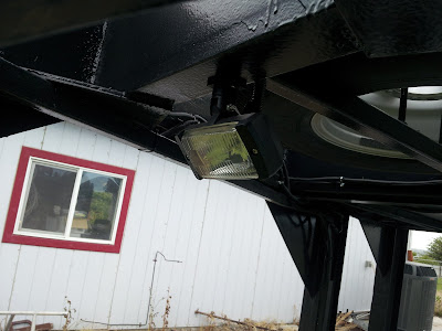

And I added a light for hooking up to the truck.
Not pictured are LED lights at the stab jack locations for setting up at night. I also added LED lights that backlight the stairs. Located in the control box is a switch that can turn on the trailer parking lights too.
