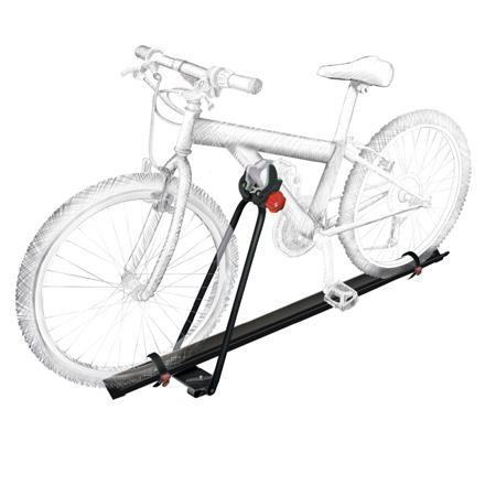

Slate -- any picture of this mounted on your truck? I have an extended cab and am concerned that the length of the roof is not long enough to spread the rack's attachment points (to the rails) for the most stable / secure arrangement. This is the rack I might consider getting.
