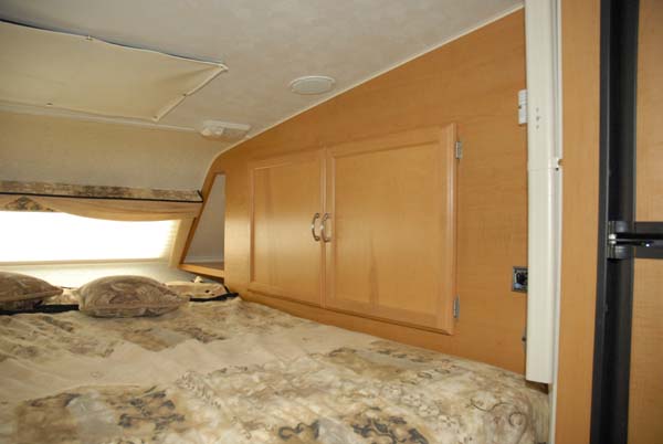

This is what it looked like with the doors closed... It was always challenging to access.
For some time we just used the wardrobe with the doors removed.

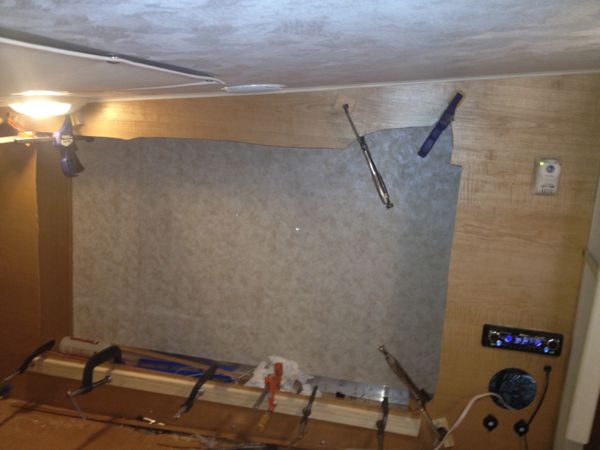

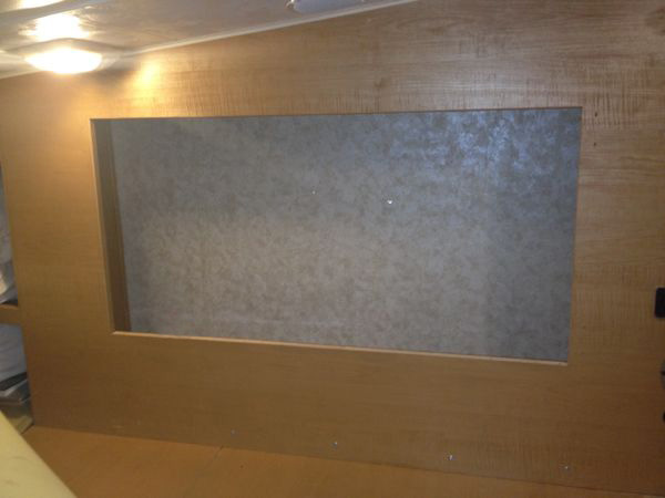

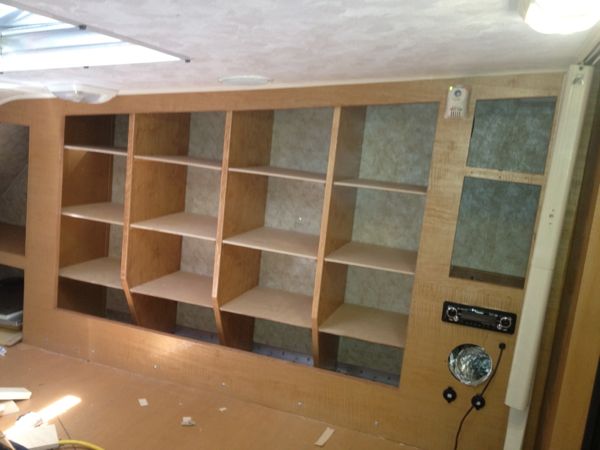

The first step in the update process was demolition. To improve access to the cubbies I increased the size of the opening.
The perimeter was reinforced with 1x2's then routed to he final size.

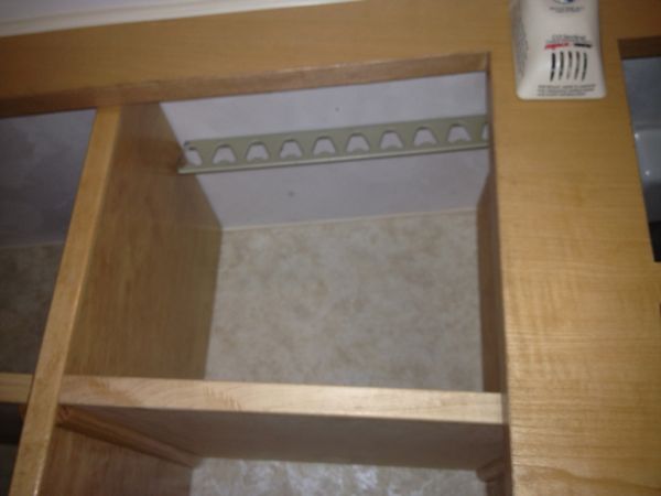

I was also able to create two smaller cubbies (above the stereo) that we plan to use for storing toiletries. This required the relocation of the CO detector.

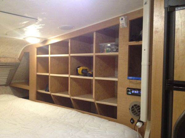

This is the final assembly. The vertical panels and shelves are Birch ply (1/2 & 1/4" respectively), facing is solid Maple.
The (6) shelves in the two vertical bays on the right hand side can be easily removed and each bay has a closet valet hanger and can store the same quantity of hanging garments as the original wardrobe. (note: we seldom bring clothes on hangers with us)

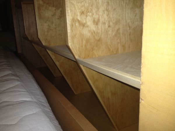

Doesn't look like you lipped the shelves, hope the clothes stay put.

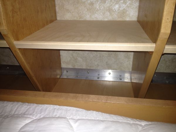

Posted: 05/08/12 12:39pm Link  |  Quote  |  Print  |  Notify Moderator
Of course there's a lip!!
The maple facing is 3/4" tall... with a slot dado'd in the back to to fit the 1/4" shelf ply.
On the uprights the facing serves to retain the (removable) shelves.
Some of the shelves will get bins (I'm still looking for perfect fitting ones) for socks & under- britches, others will just have folded and/or rolled clothing.
(note that these photos were taken before the shelves were stained & polyurethane'd)
The angle at the bottom of the shelves creates space for long items such as fishing poles, kites or a rifle.
