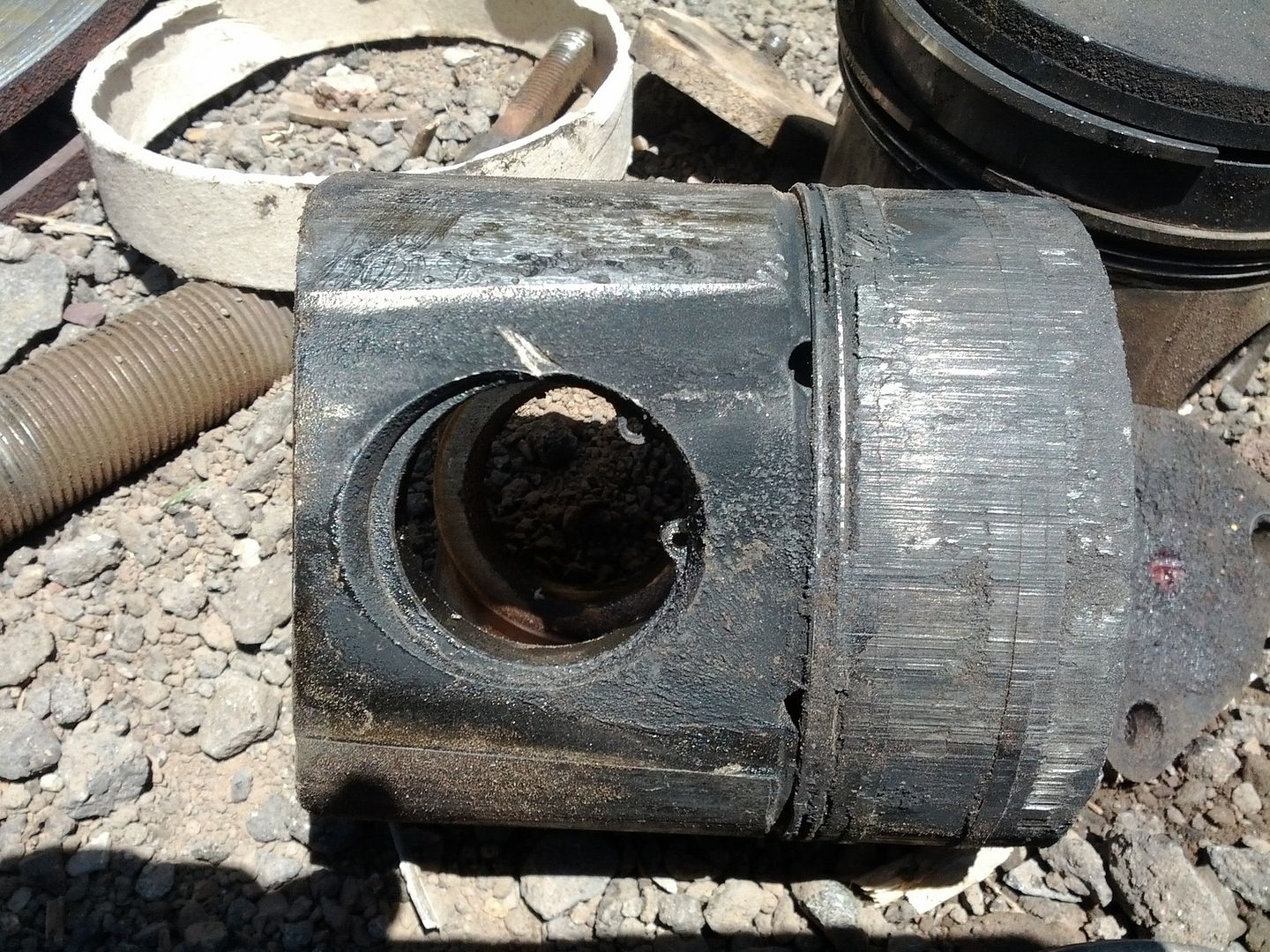

only the pistons are mine, not the other scrap
here is the head

Man that piston is bad! I am surprised they are not replacing the liners.The head looks good though. I hope your up and going soon.

I will defer to others with more knowledge, but my understanding is that this is not an aluminum block, it doesn't have sleeves/liners and doesn't use them unless over bored
Cummings 5.9L 6BT
it doesn't need oat coolant and doesn't have cavitaion worries

Just grind some of that carbon off the pistons and slap them back in there, MrWizard. Good as new.
Glad it wasn't as bad as we all thought to begin with.

The black junk on the top of the piston looks like carbon build up from lack of sufficient air or a bad injector. The scuffing on the side of the piston will probably be from over heating or less likely from lack of lubrication. Do to the side damage you did require replacement of the pistons and machine work on the block. Good luck. I have the same engine and mine overheated also. I was lucky in that my wife and I smelled the anti-freeze and the low coolant alarm came on. This happened on our way home from just purchasing our coach. The water temp gauge and idiot light quite working. Fortunately for us there was no significant damage and after the fan belt replacement we were on our way.

After severe overheating as in this case, just how much of the engine can you reliably reuse? I am no diesel expert - my experience is less than 6 months - but I would not be comfortable re-using any of the pistons or the heads! Am I wrong?

You may want to ask NAD if they can Magnaflux (or other nondestructive test) the head to check for cracks, just to be sure everything will work properly when reassembled.
