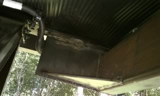

Even with a hitch welded to the frame you still need to support the bikes so they don`t bounce up and down and tear the metal on the frame/hitch or rack. I use a bolt on reciever that wraps around the bumper. her is what I did!
I put 2 stainless eye bolts through the bunk and wall studs to support the weight of the bikes. I use 2 ratcheting straps criss/crossed to keep the bikes from bouncing up and down and side-side. it`s not in the last picture but I put a setbolt through the top of the reciever to take the play out of the bike rack. I also run a ratchet strap under the bumper and over the bike rack toungue to minimize any play in the hitch. I have 4 bikes with this setup and have no failures and no issues. I have a rear view camera that I can watch the bikes with while I also watch the road behind me. they do not move at all! I have well over 3k miles with this setup and would not hesitate to keep doing it! it can be done if done properly!
