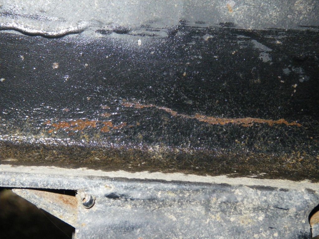

I found some cracks above the middle spring hangers of our Komfort trailer.
Sent some pictures of it to Lippert who told me the 2 year warranty was over but they would send me some fish plates to weld in above each hanger, 6 in total. When they got here I found they were 1½" deep but my frame was only an inch deep, seemed a little weird to me. Sent them another email asking about that as well as why they only supplied the fish plates when they recommend those as well as the cross bracing from hanger to hanger as show here:

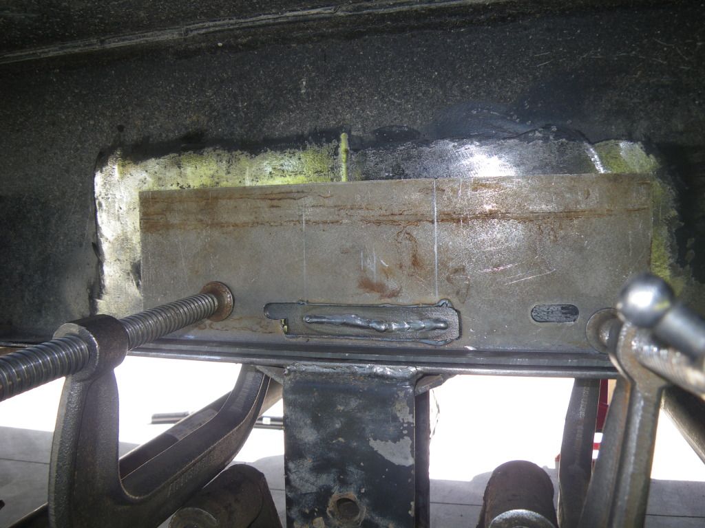

Then we trimmed the plates to fit inside the frame and welded them in:

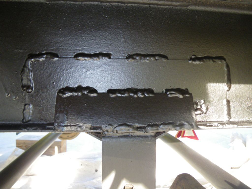

Then we added a corner gusset from the outside of the I-beam to the web like Lippert does on the newer trailers ours is an 07), here's a shot of the finished repair after a couple coats of paint and undercoating:

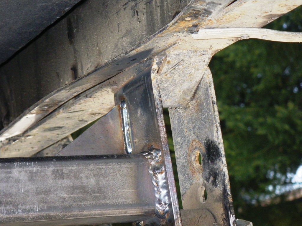

We also made some braces across the frame with 1/8" wall 2" square tubing and 3/16" gussets to the hangers:

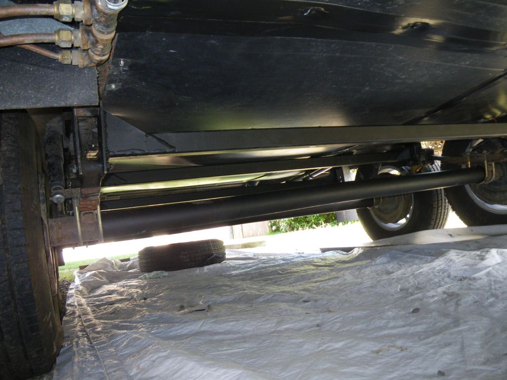

Here's a couple shots of the finished product, should hold up well now I think:
Had to re-route the grey tank drain to make room for the cross bracing, just need to spray some black spray foam around that and any other voids to seal it up to hopefully keep the varmints out, found the remnants of a couple mice in the insulation when I removed the underbelly.

Looks great.
Only minor change is 2 x gussets (triangle braces) welded on each end of the 2x2 steel tubing - instead of only 1 x corner gusset.
Other then this, great job. Thanks for sharing...

Curious why you didn't weld the fish plate all the way around and just stich welded it?

2 gussets would be overkill IMO, as would welding all around the fish plate, also someone posted on here a while ago that you should not weld all around the fish plates on a frame, he seemed to know what he was talking about. (He only used 1 gusset too.)
Since the newer trailers come with that little angled gusset on the frame and they're not having the cracking problems, I think everything we've done is plenty strong enough.
I asked about welding all around because the Lippert tech sheet said to do it that way.

Nice Job. Stitch welding is better, Welding Solid can create problems. A buudy of mine had lippert repair his frame, they did it in the driveway. Sloppiest repair I've ever seen. He sold it soon after.

I was told by a welder once that a stitch weld is better for something like a fish plate, because it will stop a crack before it runs around the perimeter. Whether this is true or not I don't know, but it makes sense to me.
