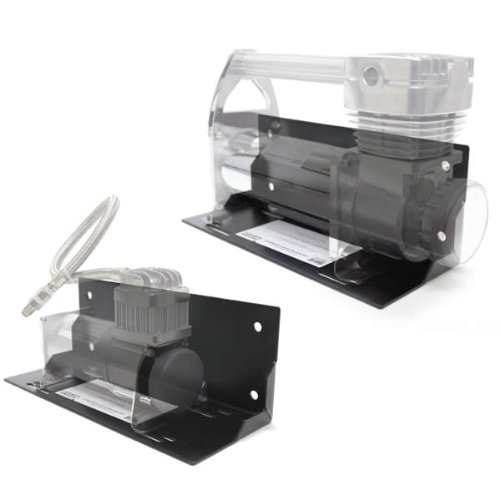

You might also try a mount plate similar to this:
that will keep the compressor upright (not that it matters) but also provide an extra layer of shielding from road slime.
The pictured plate is from Viair
