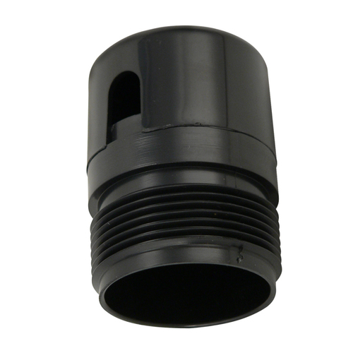

Hey Guys!
Every time I try and do a search of any topic I'm looking for such as "sewer smell from kitchen sink", it always comes up no match?
Anyway, I'm getting a sewer smell from the vent under the sink. Any advice?
Thanks,
MM.

That vent is called 'air admittance valve', studor vent.....several names.
It is just a rubber flapper that pulls down (opens) when you drain water from kitchen sink......prevents 'p' trap from being sucked dry. When they don't close off....flapper tang stretched/dirty/warped you get smells back from grey/galley tank. It can smell as bad as black tank odors.
They unscrew (hand tight) and can be found at most any hardware store (ACE/Lowes/Home Depot).
Just replace it..they are cheap.

Looking closer at it, there is a cap on that pipe that is solid on the top and has two slots on the sides. It seems very secure on there as I can't unscrew it.
BTW, I have run water in ALL the sinks, etc., and even run the dishwasher.
MM.
MM.
Should look similar.......
Check and make sure they didn't glue it on....then try to unscrew will large channel lock pliers.
Worst case....cut it off with hacksaw. Glue new female threaded coupler on and screw new one in.
MM.
Yes! that should be it! your can replace it or just take it off and try cleaning it. It might be stuck. there is also one under your bathroom sink.
