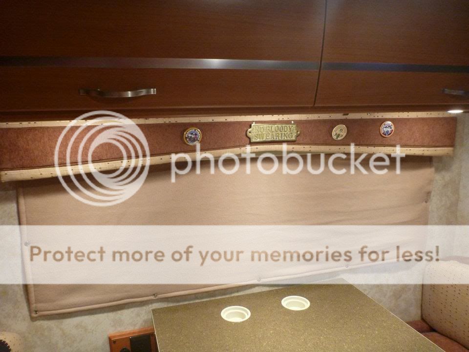

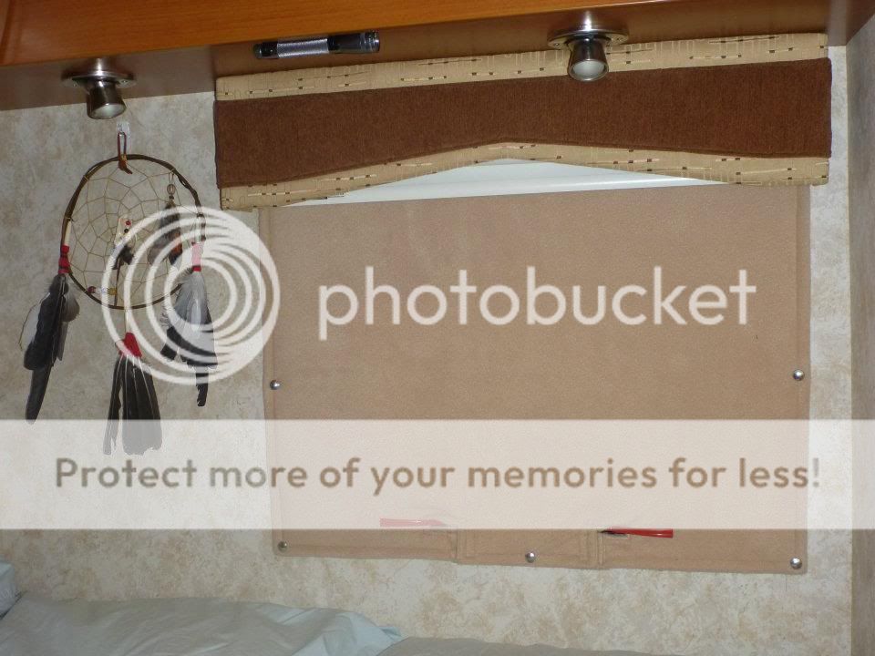

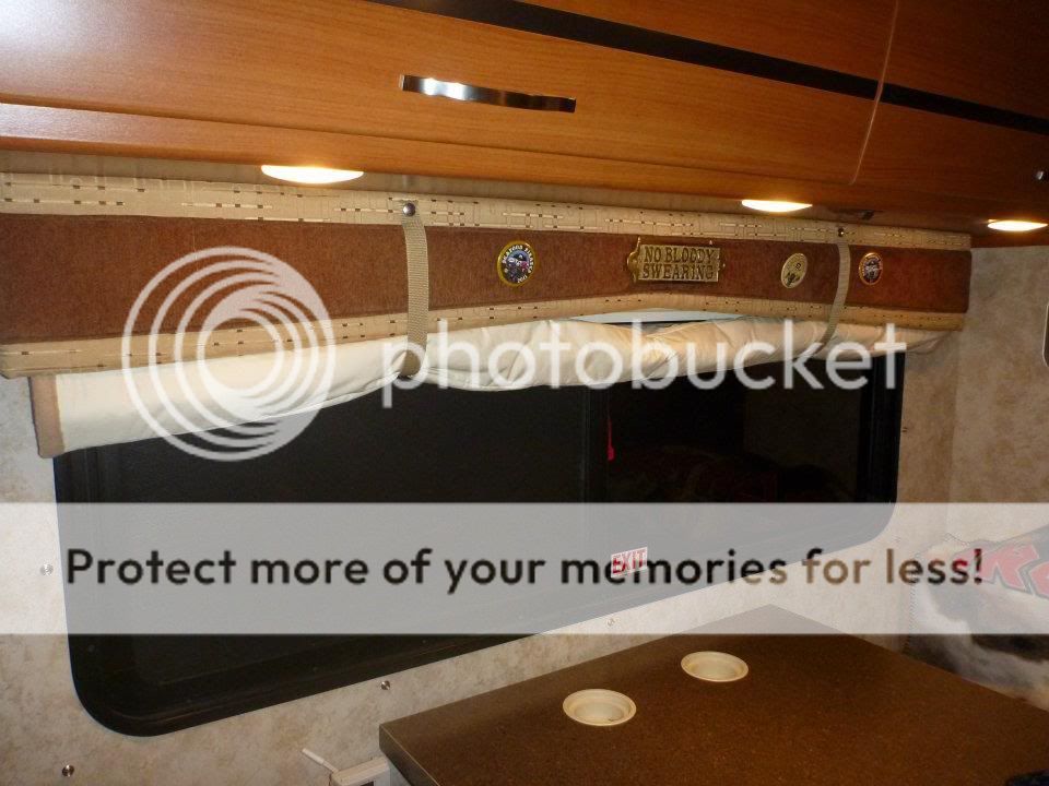

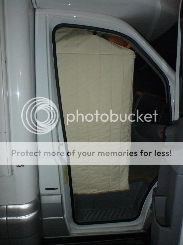

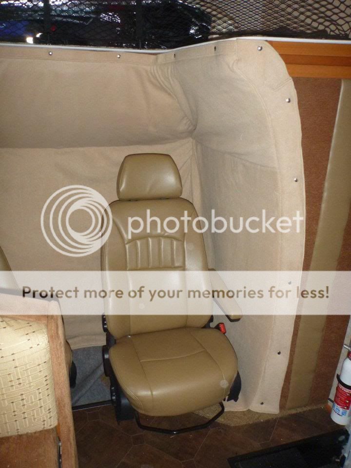

Here is the Mk II version installed on our Navion which replaced the Chinook. Same construction technique but we used snaps instead of velcro on the windows. We found the adhesive for the velcro got soft when the frame heated up in the sun and it would pull off. The velcro wasn't the most professional looking installation either. The snaps work well and we have little button covers to put on them when they are not being used. The cab curtain was quite a project as you can see. Getting around the cab seats was quite the design challenge. We've done one cold trip without them and one with and having them is wonderful.
This is the cab curtain installed showing the the passenger seat swiveled around so it is facing aft.
As seen from the passenger door

My dearest Nancy can do wonders with a sewing machine. All I do is design, then ask if she can fabricate what I come up with. The fabric came from Joann's. We wait for sales or a coupon as the Warm Windows fabric is expensive. I have since found some cheaper variants of quilted insulating cloth around so if you search you may find a better deal.
