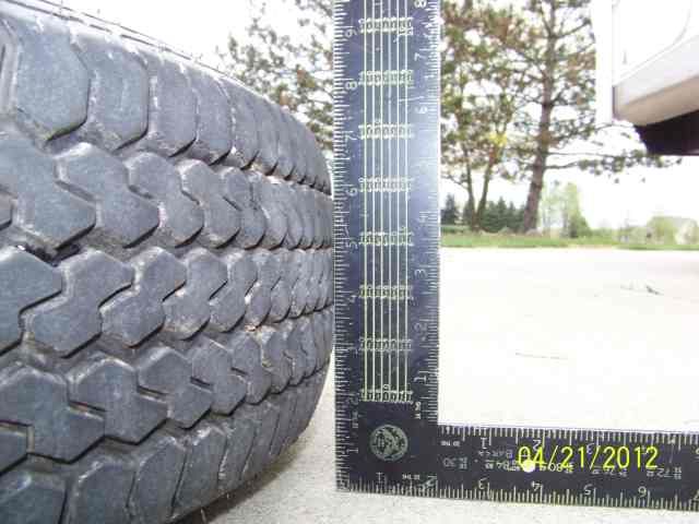

That tire may have had the rubber separated inside from the belts. Is that Load Star a ST trailer tire?
It looks like the top of the tire is round, not flat straight across like it is suppose to be. I just had 2 of these fail on mine.
Here see mine.
If you have it cut open it looks like this. I have a friend who is a retired tire engineer and I sent him the tire. This is called detachment.

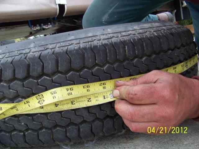

When you take the tire off you can also measure the OD and compare it to your spare. Like this. The failed one will be larger OD as it is bulged out.
I found my first one during routine maintenance. I had jacked the camper up and when spinning the tire the fat spot hit the ground. Then rolled free. The tread bulge would hit the ground then 1/2" clearance once it passed.
My last one, 500 miles later on our RV trip in late June another one failed during the trip. Same thing. I spotted it when I was getting gas and changed it before it let go. See here
If you really want to help the cause, save that tire once you get it changed. Do not give it to the tire dealer to scrap. And change it now before it lets go. File a report with the NHTSA on a failed ST trailer tire. Go to here: The one in the middle for tire complaints.

Some are saying a brake problem, If the brake was locked the tire would wear totally across the the face of the tire and or flat spots if it was intermittent. How can a stalled tire wear a wedge?
