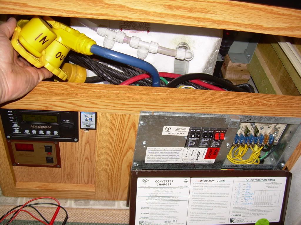

Hope the pics. explain some of the confusion, first the two pigtails wired to the main 30 amp panel ( "IN" and "OUT" )
http://s209.photobucket.com/albums/bb270........frecku/?action=view¤t=DSCN1067.jpg
http://s209.photobucket.com/albums/bb270........frecku/?action=view¤t=DSCN1069.jpg

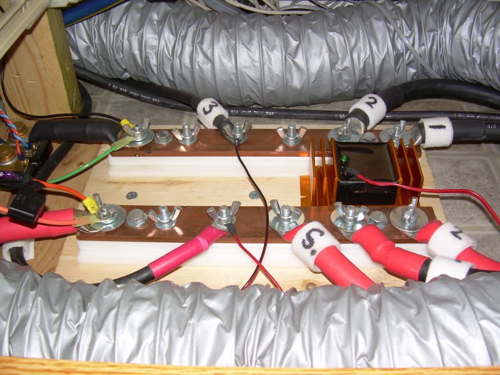

Then we have the main power bar where all the 8 batteries come in...
http://s209.photobucket.com/albums/bb270........frecku/?action=view¤t=DSCN1070.jpg

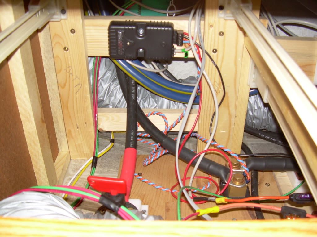

I have a lot of sensor so I can get exact amp capacity, daily usage and battery state....
http://s209.photobucket.com/albums/bb270........frecku/?action=view¤t=DSCN1071.jpg
All controlled by the computer shown on the first picture...

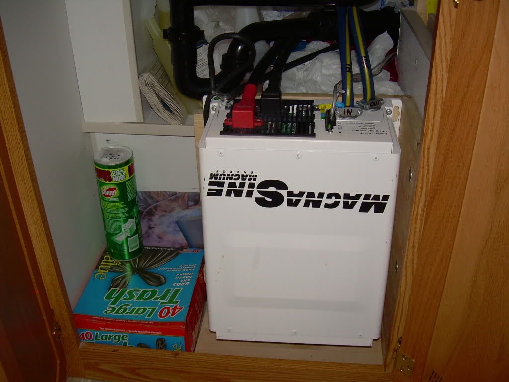

And here is the inverter itsels...
http://s209.photobucket.com/albums/bb270........frecku/?action=view¤t=DSCN1073.jpg

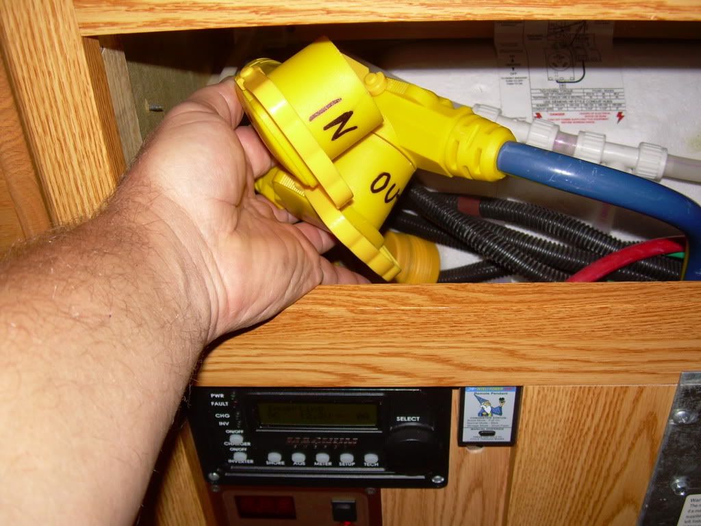

Last but not least, I like the term suicide shoreline cord, using a 30/15 amp adapter where the 15 amp prongs were removed, will not have to use one if I install a breaker switch between the shoreline cord and main 30 amp panel.
http://s209.photobucket.com/albums/bb270........frecku/?action=view¤t=DSCN1074.jpg
