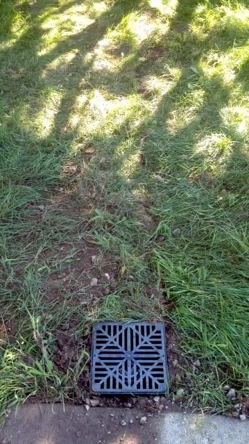

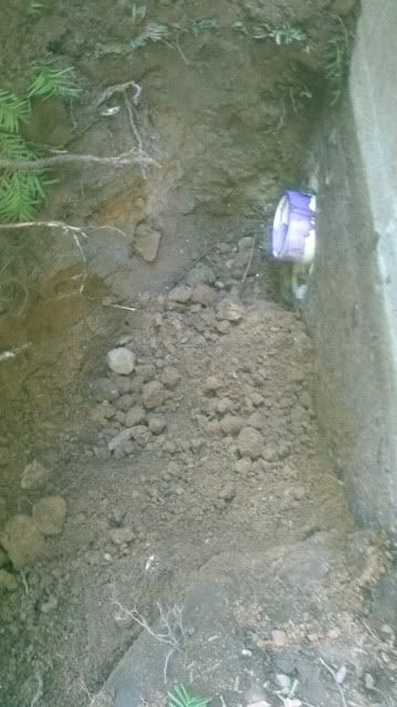

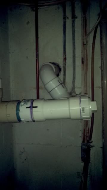

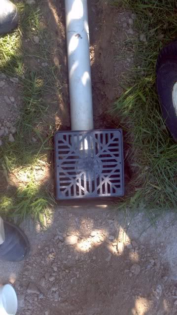

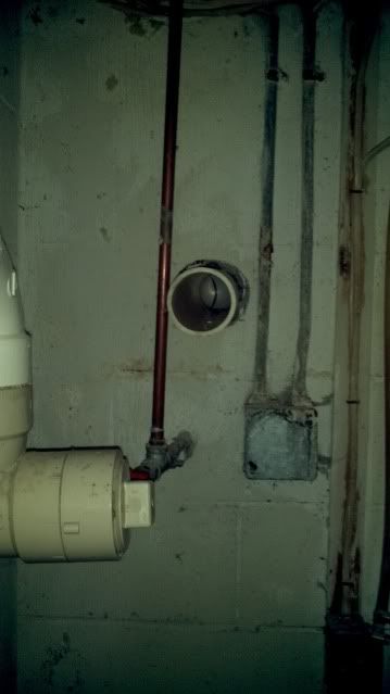

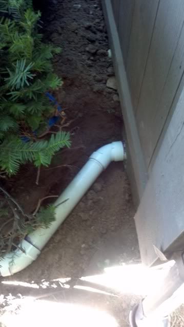

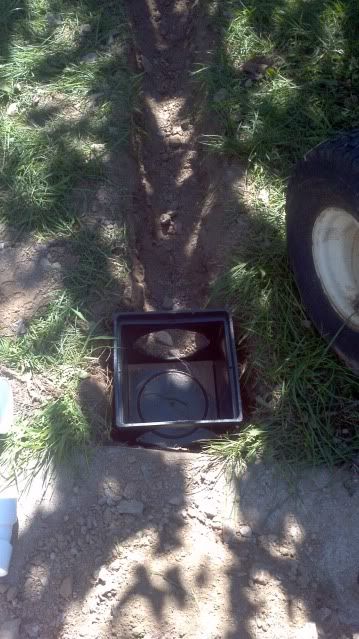

I got tired of waiting and paying to dump the tanks so i made my own into my septic tank. I already had most of the 3 inch connections, I just needed some 10 ft sections of pipe, and I wanted a box to protect the access pipe, so off to home depot.
First I dug the trench, Then I added the box
Then I drilled through the concrete block in the basement near the septic line and added a section of pipe
Then I ran the pipe from the inlet to the wall
Went down stairs and started to connect to the main septic cleanout.
inside finished product
Dump box next to driveway
Rhino adapter fits nice and snug.

In most counties rv dump connections are illegal; however, you seem to have installed a very nice clean-out.

And the award for best project documentation goes to: scokat86
Thank you. All the steps are shown, great pics, easy to understand.
