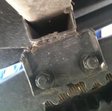

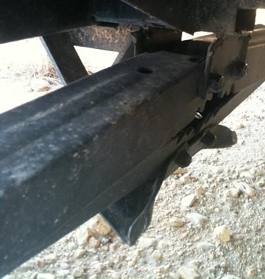

Okay. I headed over to the Colby T and looked at the damaged stabilizer. It can obviously be taken off by removing two bolts. You can see in the photos that there is a piece of metal welded to the frame that the bolts go into. When I look at replacements on line, they seem to have a bracket built on where the metal plate is. Do those unbolt from the jacks? I am confused. I have waited a week now to hear back from the manufacturer to see what brand of stabilizer they use. I need to get this taken care of.
