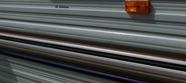

If you go with Aluminum look for what they call Krystal Kote finish. It is a hard finish that is put on the siding. It makes it very scratch and dent resistant.
Last summer my camper was in a large hail storm. My brother lost his wife's brand new Acrida SUV in it it pounded so bad. After the storm was over I went to look at the camper. I walked around the entire camper and WOW, no damage. Well that was until the sun came out. I have a piece of non Krystal Kote siding down the center of the camper. The decals are mounted on it. That 6" wide strip is peppered up pretty heavy. However the siding above and below that went through the same hail storm did not show anything. I'm sold on it.
Here is the hail
Here is the peppered siding.
It is hard to show up in the pic. It is on the decal strip. Above and below are the Krystal Kote
Sunline used it on their aluminum campers. I have seen it advertized on other brands as well. You also do not have to wax the Krystal Kote.
