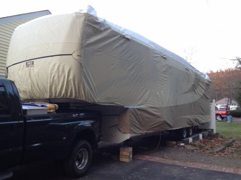

Had the dealer through in the Adco RV Designer Cover and like it's performance so far. Has weathered New England snow, rain, ice and wind with no problems and the strap system works well. We have the zippers at the door so we can still go in/out of the rig as needed.
