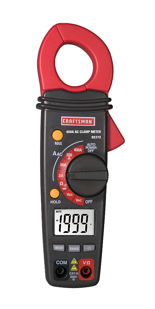

Not prof here, but the cheapest method I have seen is a clamp current meter sears sells, that can hold max reading. I do not know how accurate a meter can be for $30 to $40, but it may be good enough. If you use a line splitter, or an extension cord like I showed a couple pages back, you should be able to measure peak current, then multiple by 120V to get a rough idea on peak watts.
price
http://www.sears.com/shc/s/p_10153_12605_03482372000P
manual
http://www.metersupport.com/pages/82372.html
mitt

mitt,
Just discovered something. I have a new (Christmas gift)CEN-TECH 95683 that has a Peak Hold button. Can it capture the vary quick peak of a compressor at startup? When do you push the button, before the startup of the compressor? Many things can be discovered through sharing and inter-acting with each other on this forum. When open discussion is in use in truthfulness and kindness.
