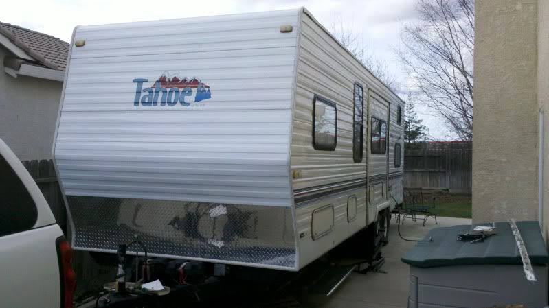

A few years ago I had a water leak on the front of the trailer between the aluminum siding and filon. The flex of the trailer separated the two.
I repaired the structure, paneling and replaced the insulation from the inside leaving the outside for later. I finally got around to it with the help of Hemet RV in ordering the aluminum siding and diamond plate. The outcome looks like a new trailer, should had fixed it all at once.
The repair was very easy, the only things I needed was time and to borrow a pneumatic stapler

After:
2001 25dbs Tahoe TT, 2005 Chevrolet Silverado 2500 Duramax
Before:
After:
Hi, what a difference; That looks so much better.
The repair was very easy, the only things I needed was time and to borrow a pneumatic stapler...
Heck, that looks better than the original! Good work!

Posted: 02/17/12 11:27pm Link  |  Quote  |  Print  |  Notify Moderator
Have to agree that replacing the filon with siding and the checker plate looks a lot better. Nice job!
