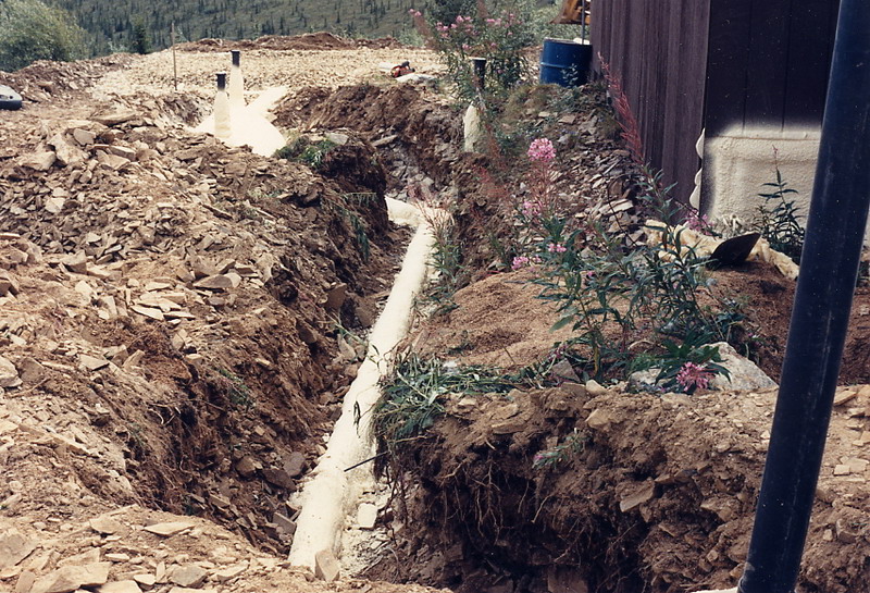

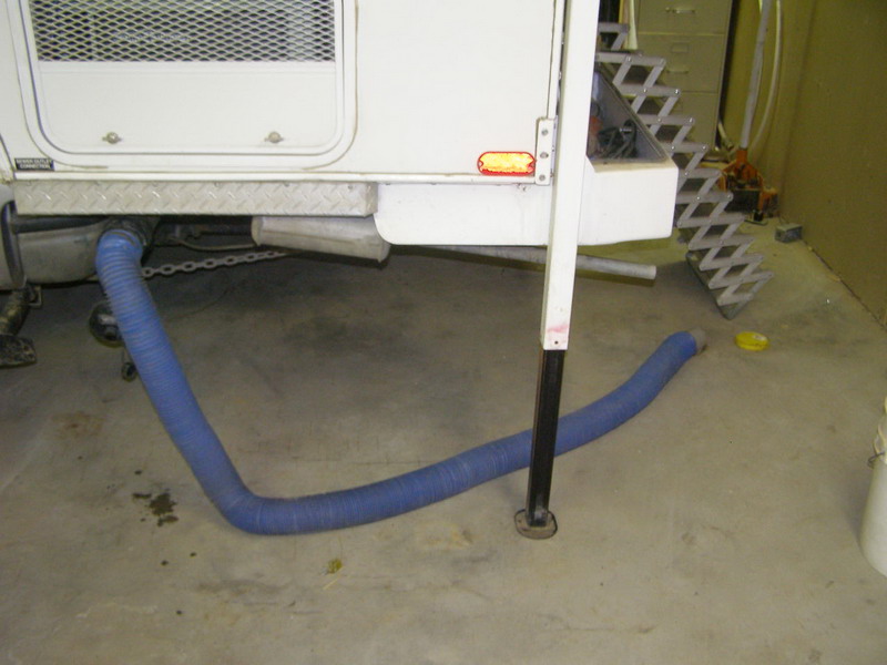

When I built my garage where my camper lives I put in the dump station you see below and plumbed it into my septic system. As one who is rather anal (excuse the pun) about plugging up his leach field I am now concerned about just that after reading your post Brad. We don't have a garbage disposal, we use screens in the kitchen sink drains and rinse the food particles from our dishes before putting them in the dishwasher. All this to eliminate small food particles that might not sink in the septic tank and get into the leach field. As you can see we have a two section tank with I believe Ts at both the inlet and outlet. I'm not sure if these would prevent a surge from an RV dump from putting small particles into the leach field. With our fairly cold ground up here I am not so concerned about chemicals as we don't have much bacterial action anyway and we have the tank pumped every two years in the fall. Probably going to change that to every year now and in the spring. I don't think the surge from the black tank is such a big deal as our new camper only has an 18 gallon black tank. After spending a week in the mountains last week snowmobiling it was less than half full so that dump could only amount to 8 or 9 gallons. The grey tank could amount to 41 gallons so that is another matter. I could open the grey tank valve just a little and let it trickle into the system.
Any thoughts,
Chuck
2006 F-350, 4X4, Crew Cab, V-10, Torqshift, Dually. 2008 Okanagan 106UDB. Both 4-wheelers and snowmobiles. KL7AY Our website
