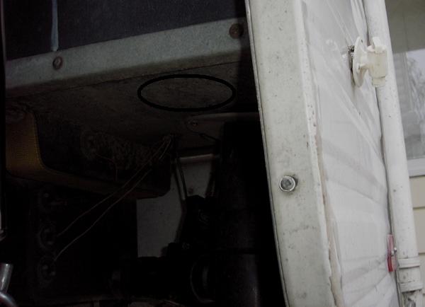

Thanks a million!! I've used forums on old Mercury outboards (Mark 58A, etc.), old Chevy trucks (1948 5-window) and old boats (1959 Sande Ace) but I have never seen such immediate and helpful responses! Thanks, guys!
I pulled the spigot and found 3/8" ID tubing with no clogging there. The aluminum siding has been buggered up so I think a previous owner also had problems.
The tubing is so short that I can't get the spigot back on. The tubing isn't accessible from top or bottom so I'm considering cutting out the oval area in the picture to get a better grasp on the situation and check for kinks. I'll cover it with a metal plate.
How else do you follow that drain line back to the tank?

The tubing was too short and was crimped at the first bend. I did a temporary fix it empties in 2-3 hours. Much better! I'll still have to cut into that chase for the permanent fix.
