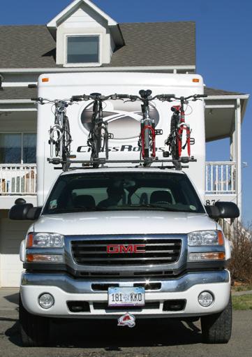

Posted: 05/30/08 11:34am Link  |  Quote  |  Print  |  Notify Moderator
Champ198 wrote:
Does the truck roof mount hurt or compromise the seals and allow leaks? Our 5th wheel has the fiberglass molded rear cap that does not have a bike rack hitch. Thanks for any feedback.
Leaking has never been a problem, but it does allow more airflow through the seal which you can hear, particularly when there is a cross wind. In addition, there is some added wind noise. I'm always listening to the radio or music and it doesn't ever bother me but it is there.
Also, carrying bicycles does not affect turning radius at all. Even carrying a 17 foot canoe, there is no possible way to make contact between the two.
The nice things about roof racks: they don't obstruct your vision, they don't fall off the back or wreck your frame, they can go with you any where you take the tow rig. The bad: getting the bike up on the rack and some wind noise.

Alan W - Excellent write up and you knew exactly what I had on my mind. I'm leaning that direction. We've got two bikes that can be used on fork mounts, and kids bike that may need a brace of sorts to hold it up. Thanks again.
