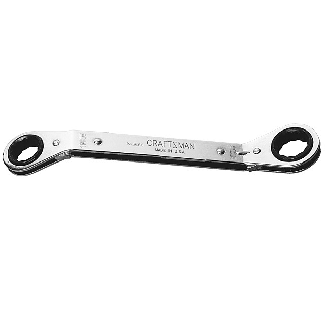

When we put down our stabilizers, I previously used a speed wrench
with a 3/4" swivel socket to run them down. Now I used a 18.6V drill & 3/4" socket. Either way only gets them loosely set. Then I use the 3/4" box ratchet that comes with a Hensley hitch. The ratchet lets me get some leverage easily. I set the stabilizers another 1-2 complete turns--quite firm. Sears offers a 3/4" box ratchet for under $10, which is a bit cheaper than the Hensley.
