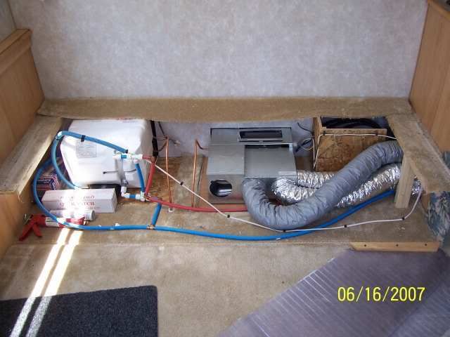

JBarca
Radnor, Ohio, USA
Joined: 12/16/2004
Posted: 01/17/09 02:41pm Link  |  Print  |  Notify Moderator
To your 1st question, installing extra ducts. Pending furnace, TT layout and the way it is built, this can be easy or complex.
See here from my prior TT. It had a Atwood Hyrotherm furnace. On this model there are extra ports where you can attach an extra duct. However these type systems do not have dampers from the factory and are not balanced so adding 1 more duct will change what ever you had before coming out the other ducts. This may not be a problem, just noting it will change and you may have to add a level of damper to balance the heat out.
The other heads up is, that extra duct will give more heat to the bed room like you want but it might be too much…. But you can baffle it down some if needed. We winter camp as well and have to set the T stat at 65 at night or else when the furnace kicks too often we roast….
The hard part comes running the duct. This all depends on TT layout. Mine older one had the furnace, kitchen sink area, bath shower area and then bed room all on one wall. The camper was built so ducts could slide down thru those common spaces to the bedroom above the floor line.
On my current camper, I have an enclosed bottom. Here 3 ducts go down in that space, convect heat off in that space then go back up thru the floor to the bed room and bath room on the other side of the camper. Here is a pic of the new TT with the cover off
So is adding an extra duct doable? yes. How complex, well it depends on the TT layout and how your TT maker built it.
We use the oil filled heater which is more passive, no fan noise running and it does not blow on us. We have this at the end of the bed about 3 feet away in the hall to the bed room. I also in winter bring into the camper an extra 120 lead line, (12 ga.) just to run that extra heater. My camper is set up so I can put the extra lead line in along with the main 30 amp cord and get the extra line into the camper space.
Hope this helps and stay warm. It hit – 15F hear last in central Ohio. Burr..

tlgardner108
Connecticut
Joined: 02/15/2007
Posted: 01/17/09 06:11pm Link  |  Print  |  Notify Moderator
John,
Thanks for the info, and pictures. My trailer uses a single metel duct down the center of the trailer. Also our trailer has a bedroom slide. Which cause the bed to sit sideways. The only heating duct in the bedroom is just inside the bedroom door.So what I was thinking of was to actually continue the duct another 5 feet as this will extend it to the other side of the bed. And give a second heating duct. As for running a second 110v extension cord into the trailer just for the heater I never thought of doning that. Thanks Tom
