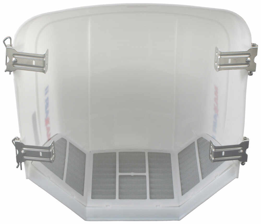

There's the wrong way, and then there's the right way...
