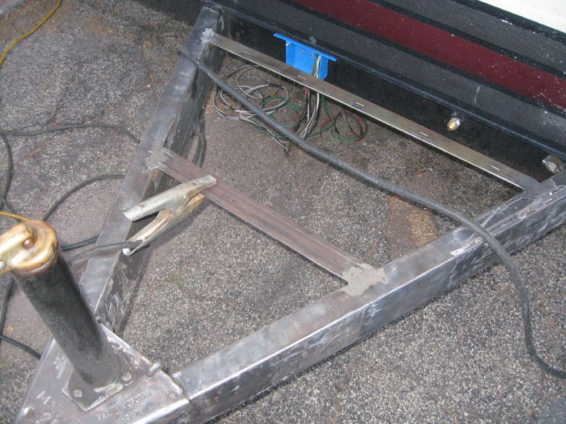

Did some welding, today. I welded two angle iron supports for the box that is going on the A frame.
Box fitment:

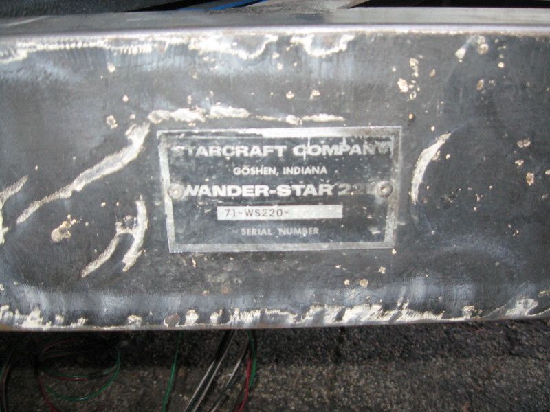

I'm painting the A frame and found that the original Starcraft serial plate is still intact and not covered with paint:
The propane tank holder and brackets needed stripping so that is in progress. After I have everything painted and bolted up, I'll be adding in the breakaway and the rest of the wiring into the new box. I think if I add partions, the box will hold the wiring, two batteries and some tools. Has anyone installed a skin under their A frame? I would think that it would eliminate any road hazard coming up into the propane piping and the wiring. It could also make for some storage between the A frame beams, hmmmm.
