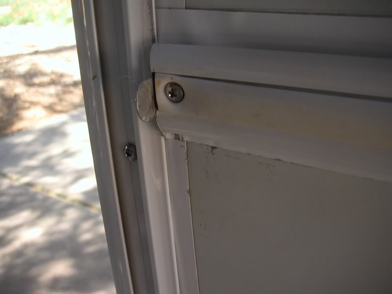

Looking at this photo of your cabover seam:
It appears that the trim might be a little detached from the edge underneath the cabover. There is caulk on the upper side and it might be pushing the trim out of kilter as oldtrucker described. The caulk on the underside seems to be unevenly applied and maybe does not cover the entire seam?
The plastic center stuff is easy to remove and reinstall. You might try peeling that out and seeing if any of the screws that hold the trim on are getting rusty. That would be a clue as to the leak.
I didn't do the cabover corners but in the rear where ours was leaking, I removed all the screws from the trim and pulled it away from the corners to install two layers of 2" eternabond overlapping at the corner and then reinstalled the trim.
Here is how the screws look under the trim and the vinyl tape gets screwed on under the metal clip which gets folded back over the tape and the end screw.
I couldn't get the last screw holding the trim strip out at the top so I left the trim connected there while I did the eternabonding. I just cleaned up the vinyl tape and reinstalled it in the channel over the screws. Also used stainless steel screws in the trim.
I should probably do the front seams as I can see some gaps in the trim up front too. I caulked them but think the eternabond edges make more sense for more protection.
