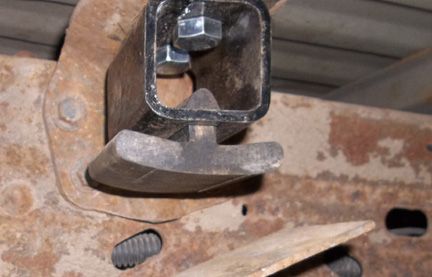

I did make my own out of 2in square tubing, When the truck is unloaded they don't engage but with the camper on they are solidly engaging the overloads. There is less side to side swaying now. A very good modification to the truck.
thanks to everyone that contributed ,you were all helpfull.
Jon
Jon
Looks great!
