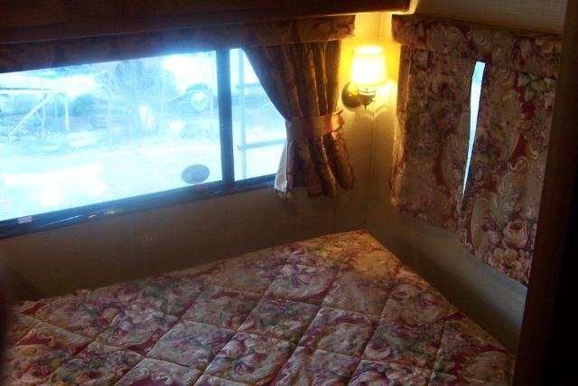

This is what it looked like before
as you can see, there is no room around the bed and it was a pain.

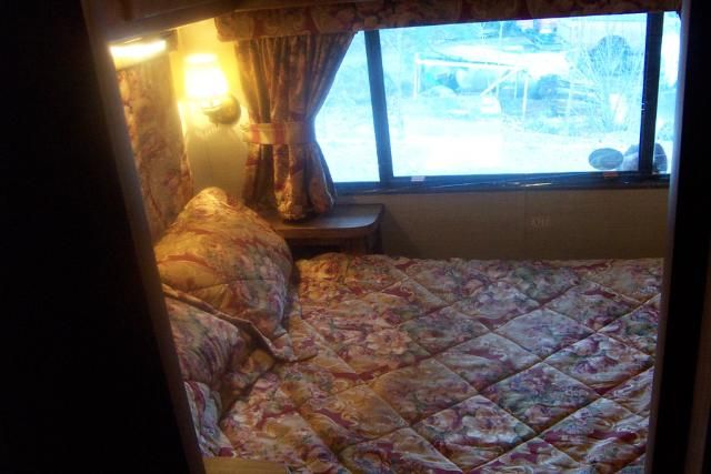

This is what we have now.

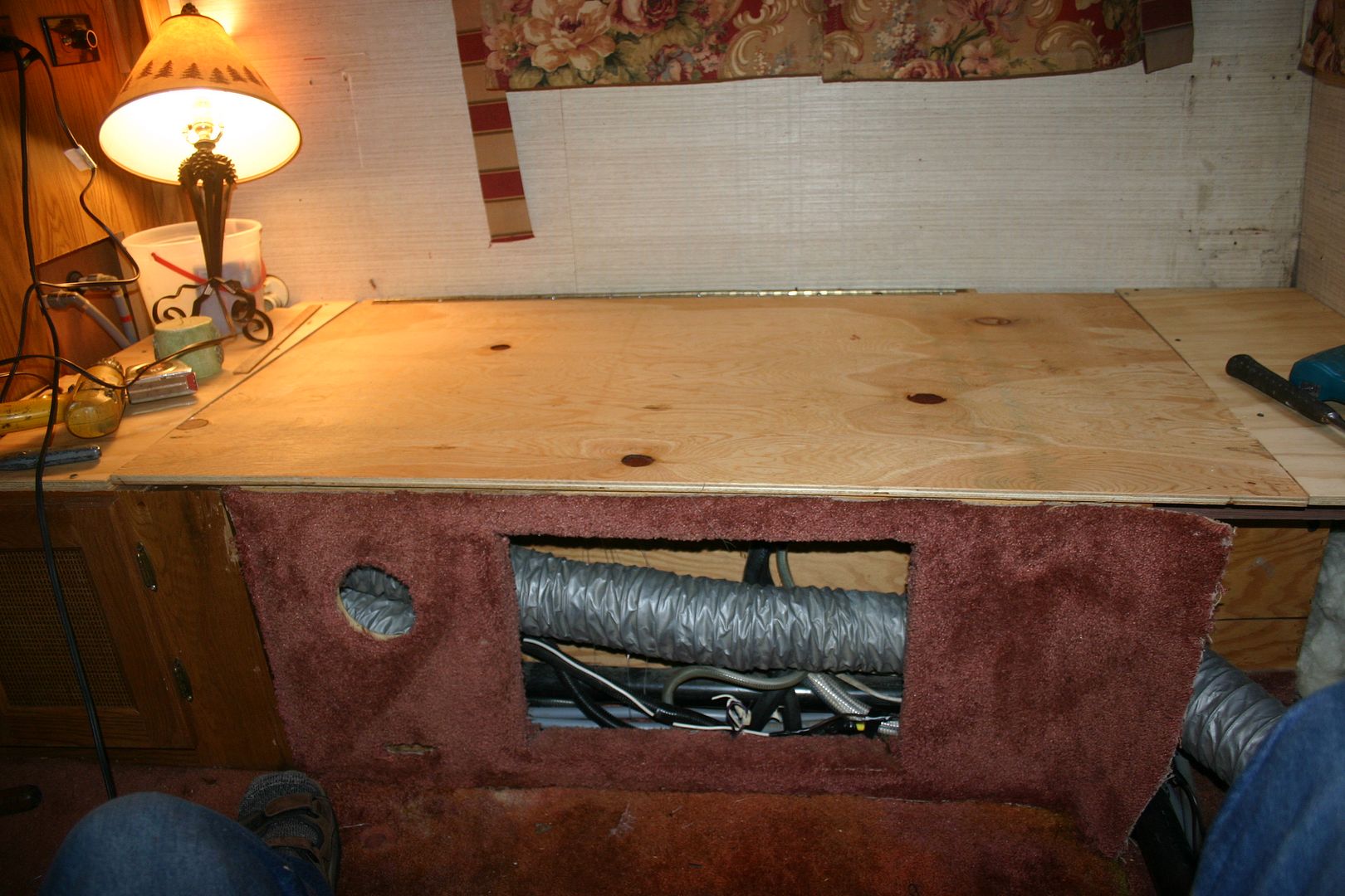

I moved the water tank over to the left side, it now balances the gen that is on the right side. As most all water lines run down the left side, I left room for a 110 elect heater to keep it warm while parked and the heat also travels all the way to the kitchen sink, no frozen lines.The water pump is now in front of the tank and is accessed by lifting the bedding and opening a trap door, no more crawling around.

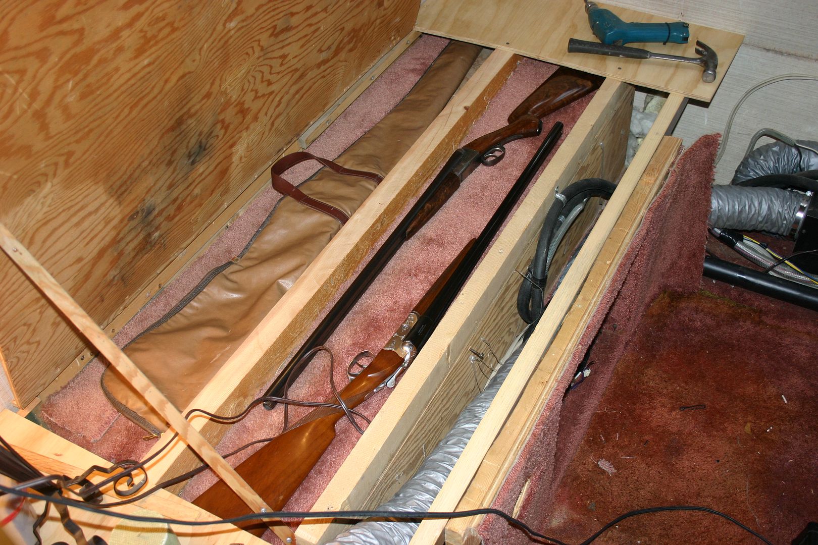

The bed on the right is over the gen housing
and I used the space between to store my shotguns

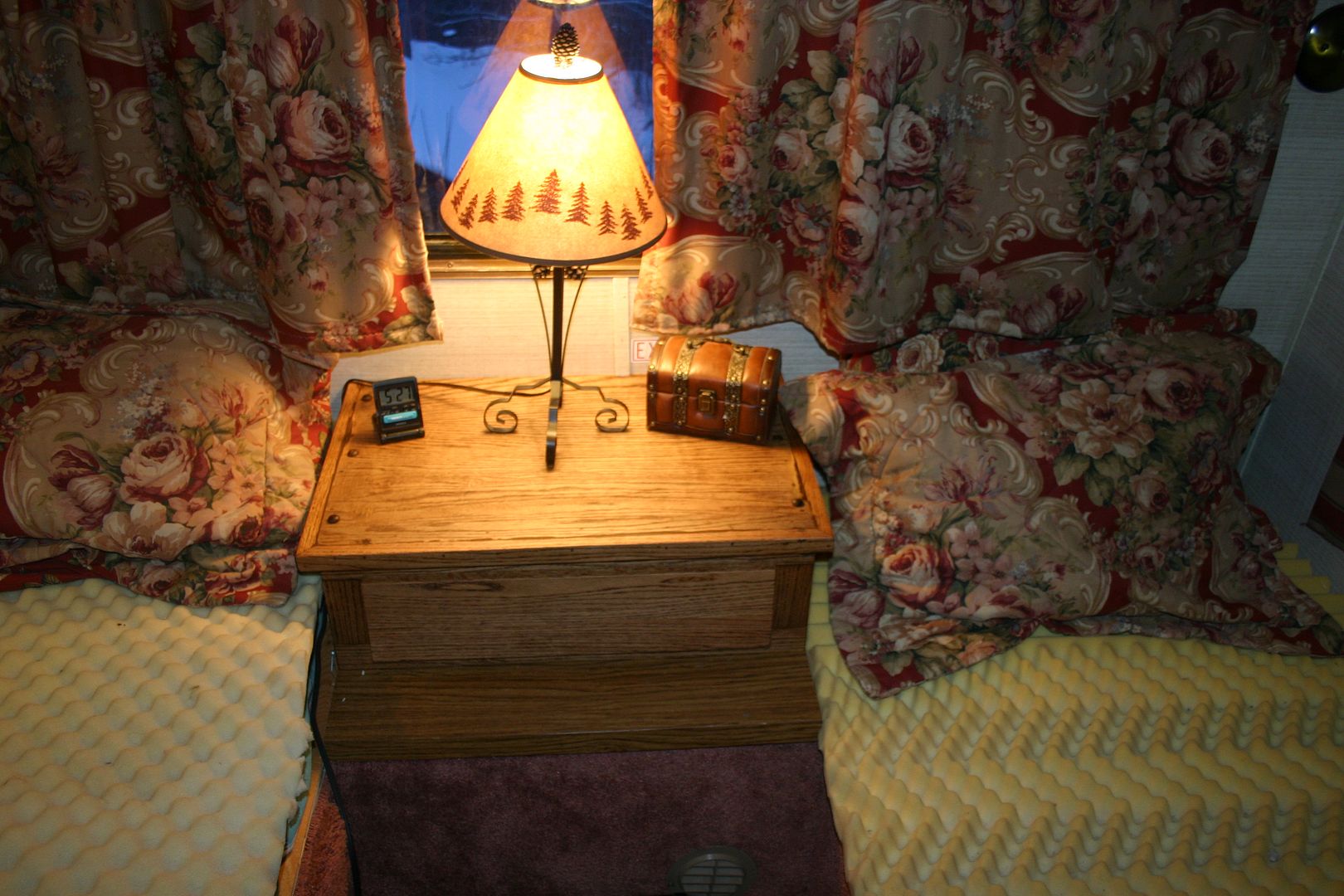

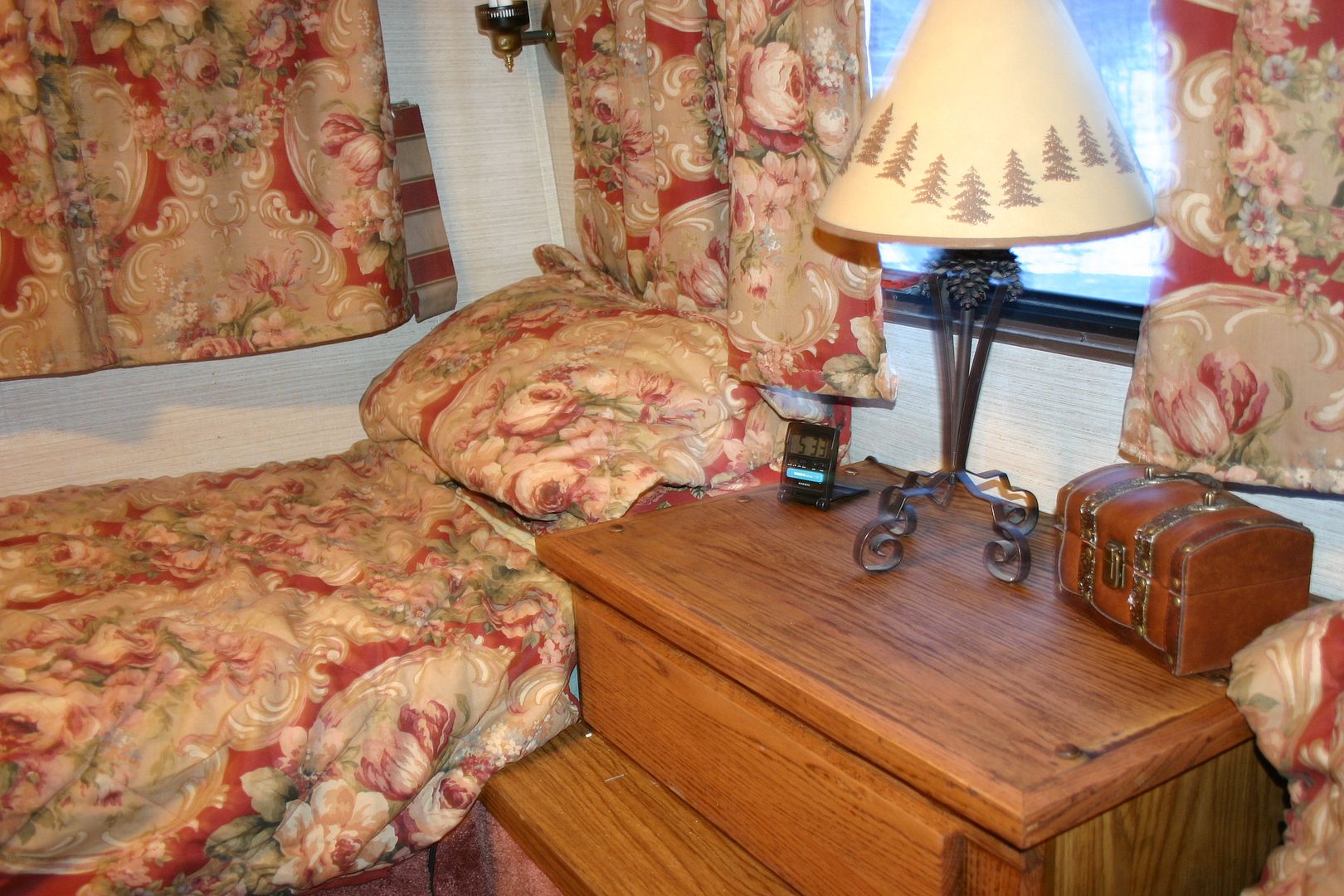

We built the night stand between the two beds, which gave us extra storage and it houses the engine heater.
Now when we get up in the middle of the night, nobody needs to climb over anyone, I can read and my light doesn't bother her and we have a place to change cloths and can reach all the cabinets that are over the bed with out standing on the bed to do so.....

There is no load on the walls, all load is on the floor, my bed is over the gen, the wifes is over the water tank.
