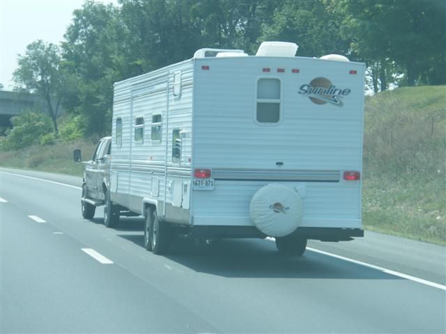

The 93 7.3 diesel is an indirectly injected engine and naturally aspirated (No turbo) If you want more power from what you have, a turbo charger would be the best guess. If you are interested in learning more about your engine and the options available to you, try OILBURNERS There are a great bunch of guys over there, that will be more than happy to help you.
I towed our 8,000lb TT with my 93 F250, with the non-turbo 7.3.. It wasn't fast, but it got me there.
If you want a better towing experience and more power for the hills, I would suggest a 1995-1997 E350, with the 7.3 PowerStroke engine...
2003 Sunline F-344SR fifth wheel
1999 Ford F350.. 7.3 Dually
