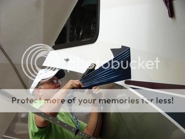

I removed the decals from my '03 Phaeton with a heat gun and plastic ice scraper. There was virgin gelcoat underneath the decals. There definitely was a "ghost" impression of where the decals were. We had identical graphics painted on at Red Bay, AL by Bruce Deaton.
Here I am removing the decals with the heat gun:

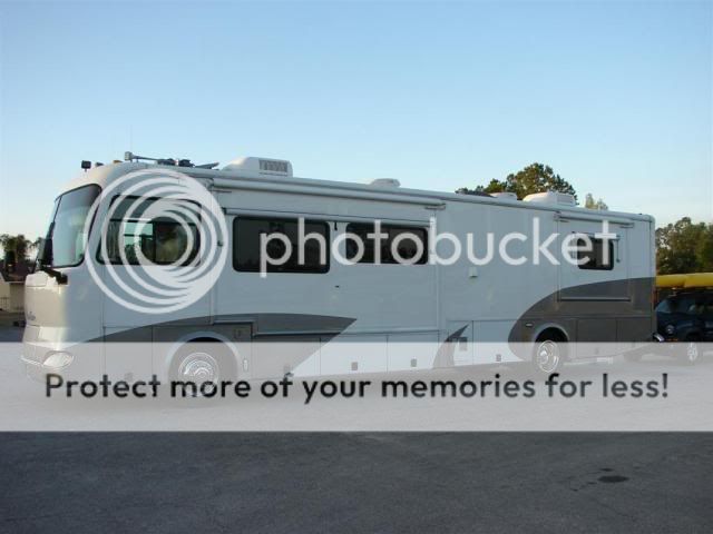

Here you can see the virgin shiny gelcoat. Big difference between the protected area and the weathered area next to it:

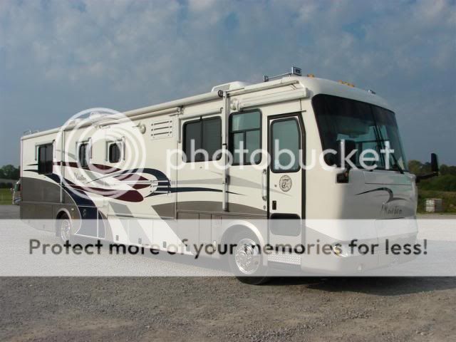

Here is one side of the rig with all vinyl graphics removed:
Here is one side of the rig after new paint job:
We are very happy with the results.
