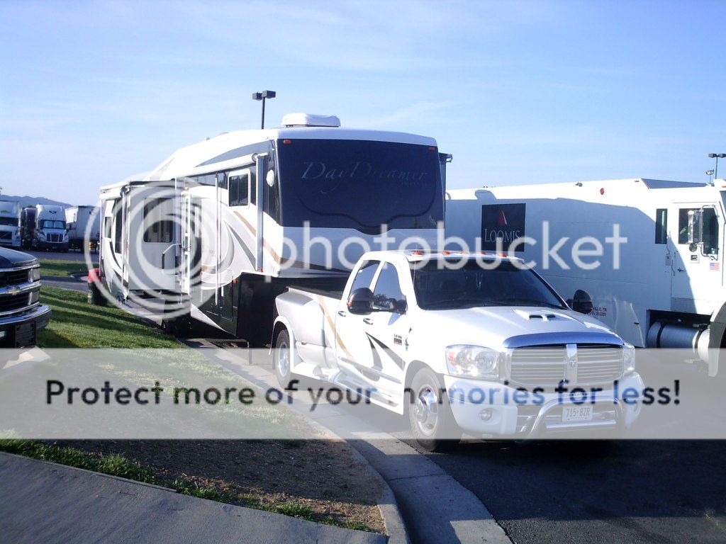

I've got both a 6.7L diesel dually with a 8' box and a Jake-Brake and there is no way i'd do any serious travelling without both,now mind you we go south every winter now so i look at my rig as a required set-up for what i think as "safe travelling" which it to say my 6.7L Cummings has the torque to haul 16.000 LBS up the smokey mountains with ease and the Jake Brake to spare my brakes and help slow down on the way down. I find that having two rear tires adds tracking and stability with cross winds and in the event of a blow-out the extra wheel goes a long way to relieving anxiety and stress while travelling. All in all i consider my rig to be optimal for what i'm doing and i wouldn't change a thing.
