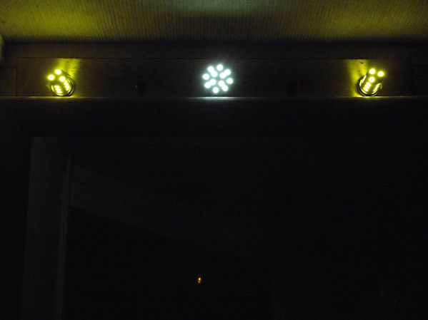

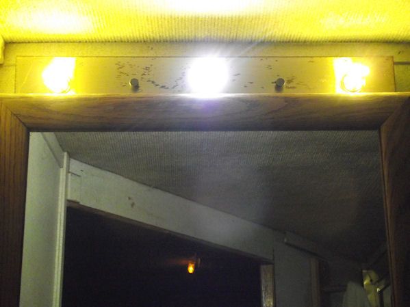

lots of LED lamps with BA15s base likely to fit the bill
Bath fixture with 2 corn and one 30mm wafer LED assemblies.
wafer assy uses a G-4/MR11 to BA15s adapter..
Super Bright LEDs is a page to start looking at.
I tend to stay with assemblies which use the 5050 led chip.
And buy from china at half the price....
converted 11 fluorescent fixtures to LED
