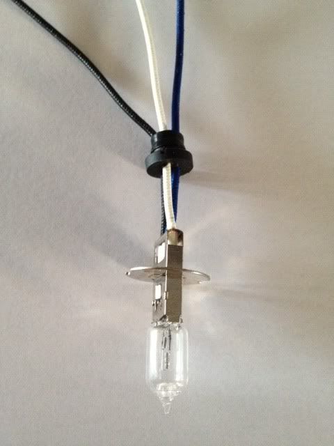

I know this has been discussed before but I am looking for a source of these DUAL filament bulbs - 25W Low and 50W high.
It is rediculous to pay $48.00 for the whole lighting assembly when only the bulb is bad.
They do offer just the bulb for $18.00 but that is robbery.
Someone had to make these bulbs for WW
The bulb has H3 12V50/25W written on it
Has anyone found a source other than the few WW parts dealers?

My 2006 WW used single element H3 bulbs. I replaced them with automotive 55w models although the leads were shorter. They now make H3 LED replacements with 60+ SMD elements that take a fraction of the power of the halogens. They are a little less bright, but put out a whiter light that illuminates well. Even on battery power, you can run these for hours without worry.
