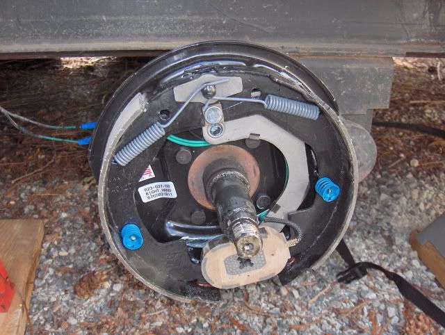

I thought I would be replacing my brakes after 25-30k km of towing. Was I surprised after pulling the drums to have a look and repack the bearings:
Brake photos

When I did mine, I did the new backing plate route. My 10" assemblies were only $40 each. That was the whole ball of wax. Remove 4 bolts and cut the wires to the old ones. Put the new ones on and connect the wires again.
I didn't do the drums at this time. They seemed fine and a year later, still seem fine. Took a little bit of extra boost to 'seat' the shoes in, but now they are great!
