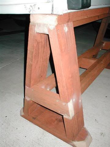

My "saw horses"- shown with end grain primed before painting. I copied from anothers idea several years ago, just adding thru carrage bolts. What makes these 'saw horses' work, in my eye, is cut angles in top legs and back runner.
As seen in end view pic, as bearing wieght applied actaully makes them stronger as it forces the legs into center. 2x6 legs enough to resist side to side. Full weight on them and zero rock, BUT in actual use I only lower enough to keep camper from moving on legs, the campers legs just have a wider footprint, stiil carry most of the weight.
these are also pressure treated, I was going to add a center leg each end but the shallow angle 15d, this seems to be ok, For 48"
or greater leg spread, think I would. Certainly not carry alongs Mark

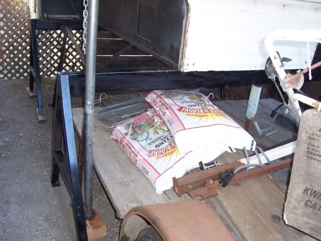

I built a set similar to AnEv942's, based on his pattern from a thread he posted. Mine have just a bit more spread to make me feel like they are more sturdy. While I like my camper low, if you follow his pattern, you could make them as tall as you would like. I would bet you could cut the legs 48" long, they would be close to 36" high. My wife likes the camper low so it's easier to get into when she's loading it, it's just a long step to the camper bumper. I span the gap on mine with 2x10s, and my camper feels more sturdy on the "camperhorses" when I am moving around in it than it does in the truck. I take some of the strain on my jacks, too.
If I planned to unload when I was camping, I could haul mine, they feel like they weigh less than a 40 lb sack of dog food.

Posted By: AnEv942 on 10/19/10 12:00pm
And mine were patterned on Kodiak K99s just to give credit, with suggestions to use bolts since mine are taller. Allthough Ive used mine to hold camper while changing out jack brackets, restating what others have, they're not meant to hold camper, only stablize-keep from swaying while stored.
Kodiak K99 thread
Noted 1 of the pics url is incomplete http://pic15.picturetrail.com/VOL628/2685851/5365360/68973374.jpg

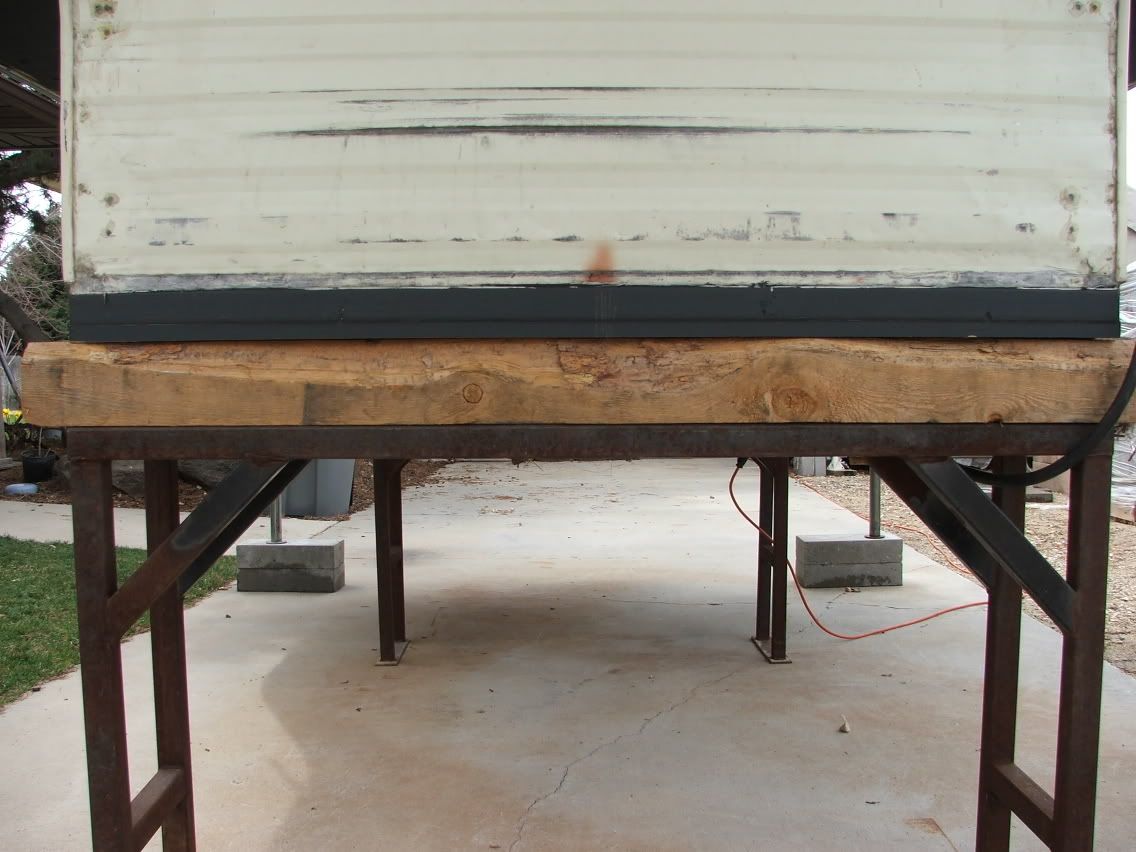

When I had my Caribou camper I made 2 stands that was the height of my 93 chevy. I had to then add some 4x4 when I got my 2000 ford. here a few pic's of the stands. 7 Pumps on the jacks and I was ready to load on the truck. I only have these pic as I gave them to the guy how bought the camper, so can not measure them for you.
front up close
Side up close
overall pic, note I have solid cement blocks for the jack stands.
Good Luck and Happy Camping, Robert
* This post was edited 10/19/10 03:10pm by Berticus *
The Setup:
96' Serro Scotty 25'Dodge,4x4,Diesel,Class-C, 86 20' Chris Craft LTD.
