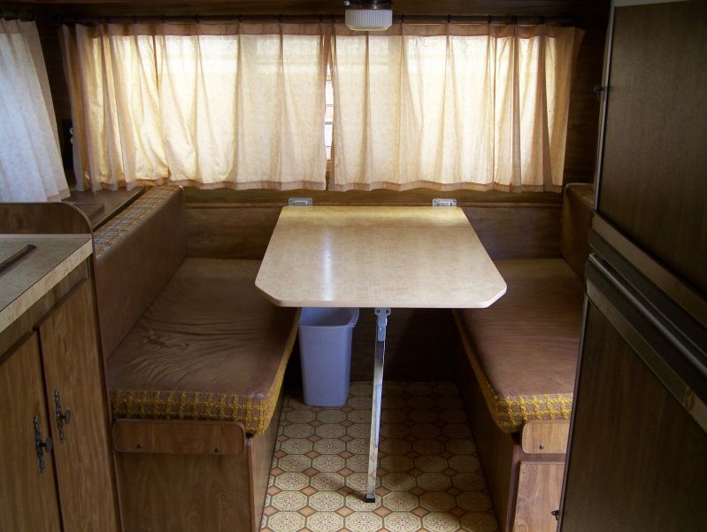

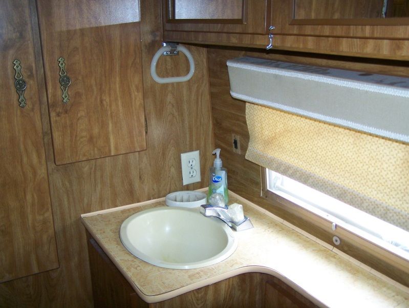

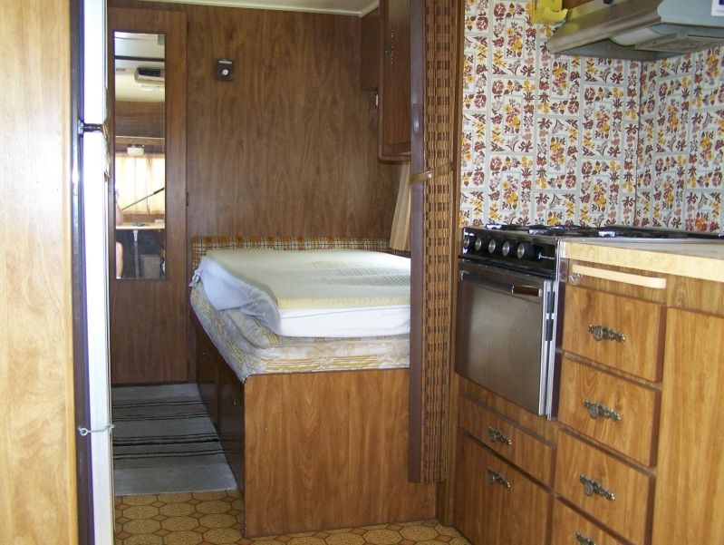

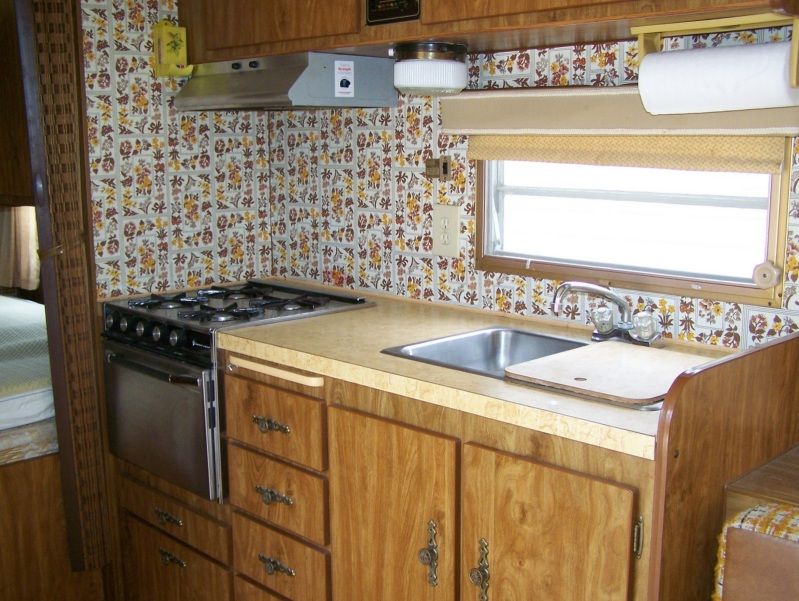

Thought I would share some int pics. I looked a while to find the best TT in my budget and I (more important... the wife) are very happy with this one. Everything works. Cold A/C and Fridge. Paid $2000.

Nice looking trailer!
Do you have any more info on trailer?
Model # etc.
I bet somebody on here has one or can find it!
